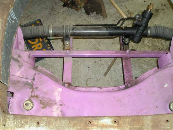

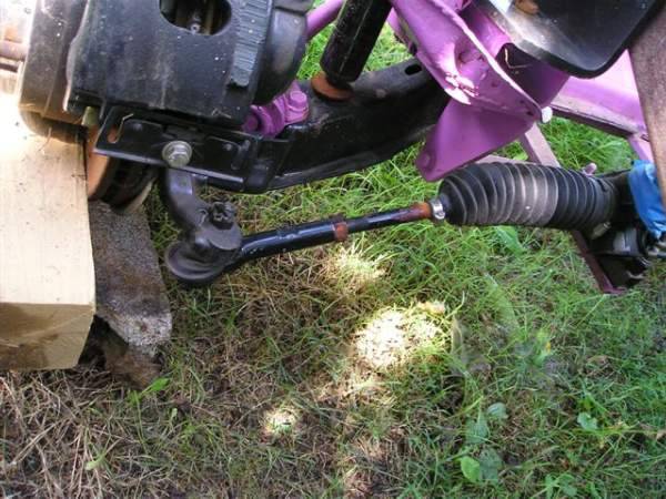

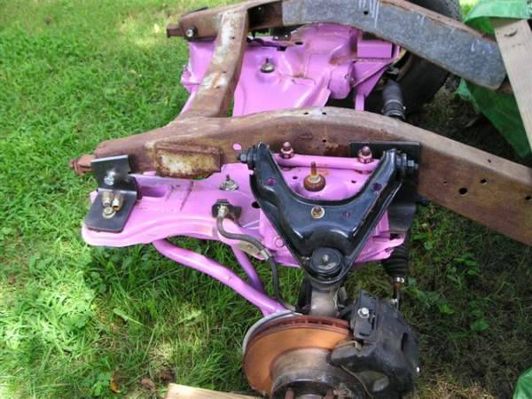

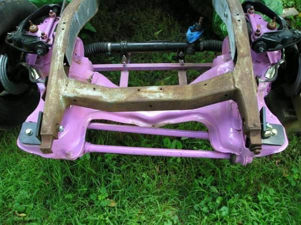

Rack & Pinion... Home made....
"These are pics that Terrarodder here on the HAMB sent me of how his buddy attached the rack to cross member ,1" sq. tubing and 1 1/2" channel. One pic is the Kcar steering arm welded to the volare streering arm . that way you can use the Kcar tie rod ends and just shorten the tie rods.
gdub"
As much as I respect innovation.... I don't thnk I'd try this approach myself...
