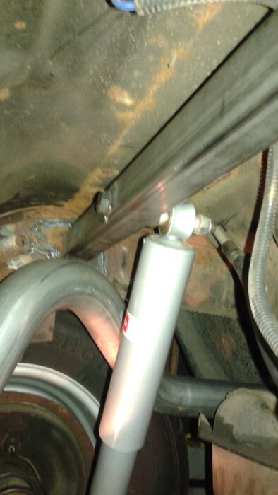

Absolutely should add subframe connectors and rear sway bar.
Whenever I get around to dropping and replacing my fuel tank, I also want and recommend adding plate/re-enforcing the upper “mount” for the rear shocks too.
2,991
Subframe connectors are HIGHLY recommended. When I originally went from 225 to 440 back in '89, didn't have connectors. On hard accel, a 1/2 gap would open between the door glass and seal. Around 1991 I welded in subframe connectors and the difference was amazing. They also helped the handling, and reduced squeaks and rattles about 500%.
SRTMirada
Dec 29, 2015
116
74
Niagara

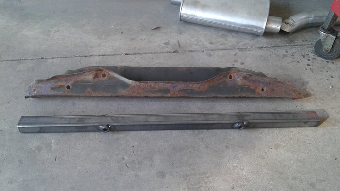

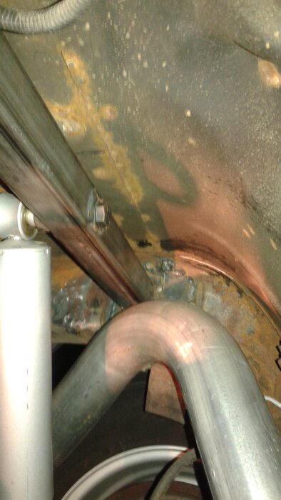

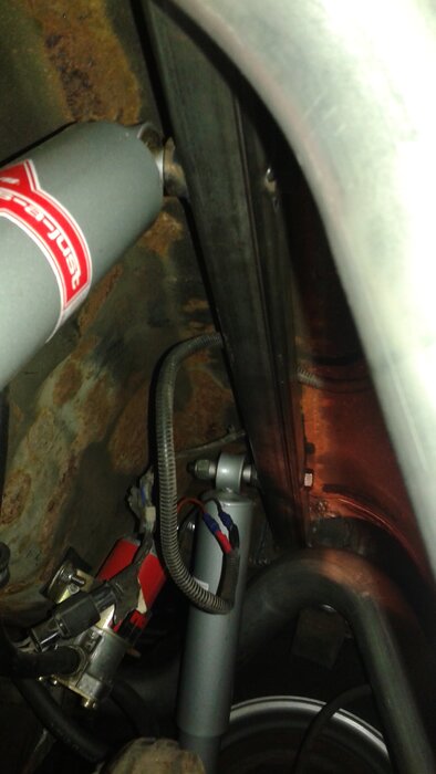

I removed the flimsy shock crossmember and replaced it with a piece of mild steel tubing. I would absolutely recommend this modification. It eliminated a "boing" sound that used to come from the back of my car.
