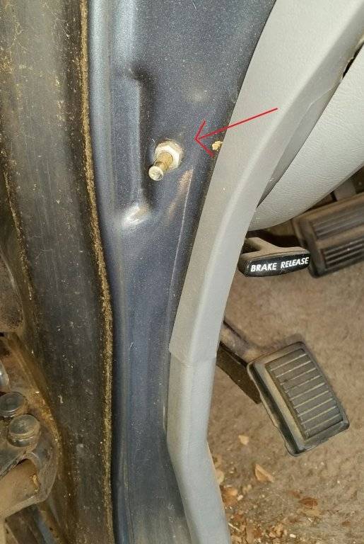

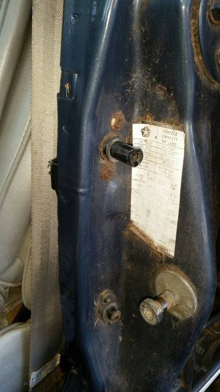

The dome lights operate off of the Door Ajar sensors on your A (and B – if applicable) door pillars (only) and look like the picture below.
On a side note, my ’77 Wagon does not have door ajar sensors for the rear doors. There is a dimple on door pillar, where I could drill a hole for the switches, Remove both trim panels, un-tape the pigtail from harness, install new switches and presto – my rear door ajar lights work.

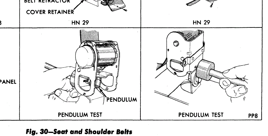

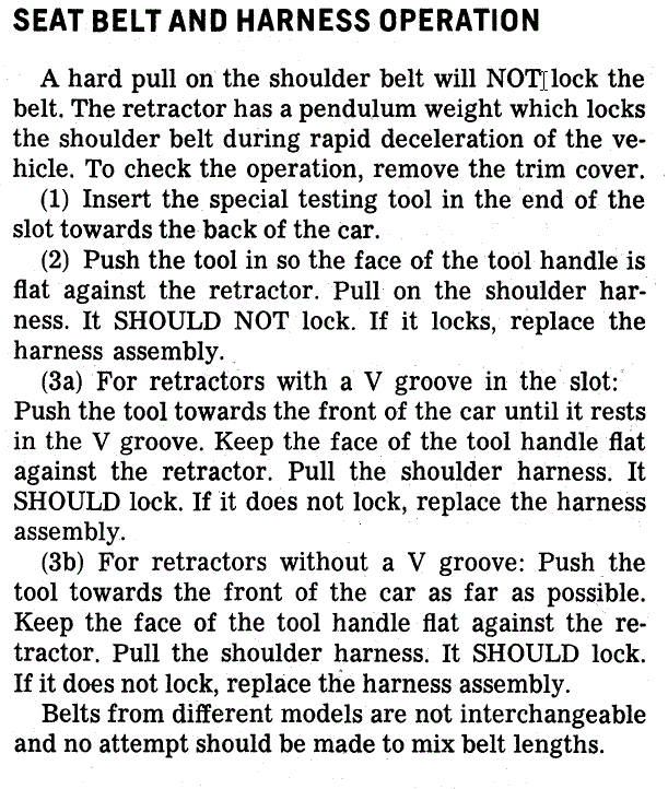

The nest two pictures are from my ’77 Service Manual.
