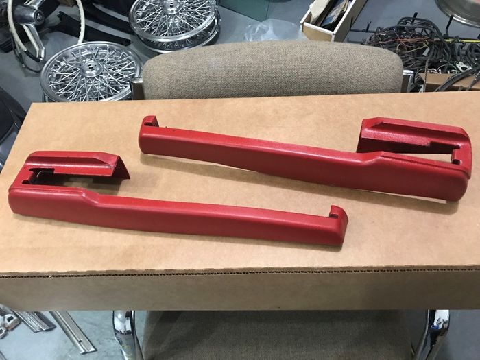

Not mine, but here is something that, if needed, would probably be hard to find. Just in case someone might be looking for them, they are on EB right now.
PLYMOUTH DODGE CHRYSLER VOLARE MAGNUM ASPEN CORDOBA SEAT TRACK TRIM COVER PAIR | eBay
2,992
I'd say impossible so,,,,,,,,,,,,,I snapped them up before I could change my mind. I have only the drivers side outer cover and this is the first time I've seen any for sale.
2,992
should have posted a wanted ad. i have a black pair sitting in front of me.
It's one of those things you need, but forget you need until you happen across them. I looked around a few years ago and came up empty so I basically gave up.

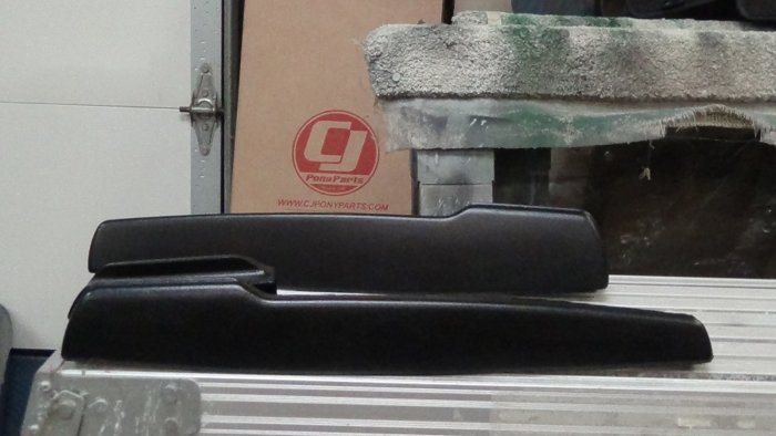

The covers came yesterday and they are in excellent condition. Aside from one teeny, tiny scuff, they're perfect. Now, to make them black. It's supposed to be in the mid 30's so should be warm enough to get them ready, go outdoors and spray the SEM and back indoors. I don't want to shoot them in the garage with the cars in there. I did that once and then spent the next couple days with the clay bar and rewaxing both of them.:oops:
2,992
Now that I found out the left outer is also the right inner and right outer is also left inner, I have 3 out of the 4 covers now. Made them black today with SEM "Landau Black". I cleaned, cleaned and cleaned again with SEM Vinyl Prep and then Dawn dish soap and warm water and,,,,,,,,,,,,,,they turned out nice.

Look nice. Btw, Like I said on the other post if you have seen it. I don`t think that they had inner covers. None of my cars have them.

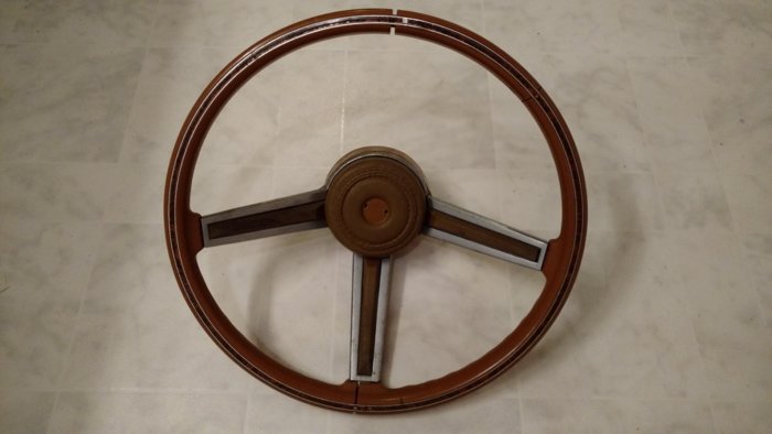

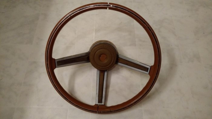

They look great! I don't have any experience with the SEM paint/dye and cleaner. Would the SEM dye work on the more flexible plastic parts of my "new" SE steering wheel? I'd like to dye the three horn strips and the center cover of my wheel due to fading and discoloration in the original "butterscotch" color. Where do you get SEM products?
Most real auto parts stores that handle any body shop supplies. (not a chain like Advance)
