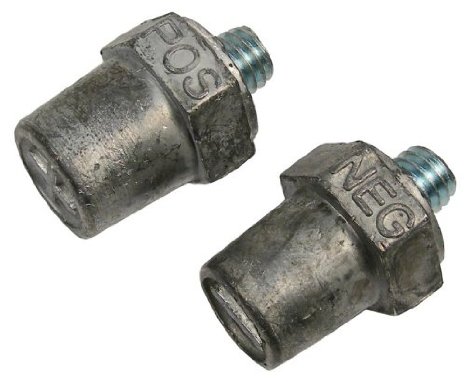

they Make Side to Top Post and Top to Side Post Adapters for the Batteries. I for one can't stand Side Terminals either. You could get the Adapters, or just replace the Cables with some top Post Generic Cables if Possible.

A couple of small points. Poinr 1 is if you need to charge up a side post battery, there are bolts available at any hardware store that fit. The bolts/threads are pretty common. Point 2 is that my 2006 Monte Carlo uses a top post battery, because the engine compartment is so tight that the side terminal battery if used, would have no clearance for the battery cables. Weird, huh?
