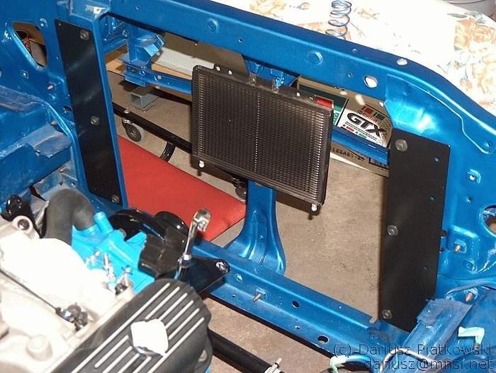

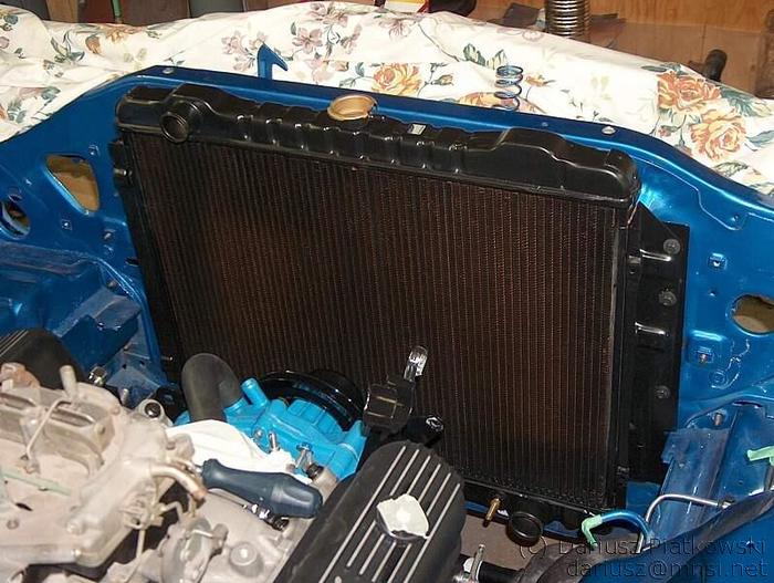

On my M-body I needed to fabricate mounting plates for the rad. This is because the V8 had a wider openning in the front section whereas the /6 was narrower. This meant I was not able to simply bolt-up a V8 rad. No problem, easy task, here is how this turned out:
1) plates
2) rad mounted

22" Radiator will bolt right in,You probably have a 19" with the /6

If your asking about front suspension it is the same for both I believe. I opened up the coresuport on my 76 F body for the hd rad for a 360 and it bolted in. It's possible that the ride hight will need a small adjustment.
Edit: the holes for the hardware were in the coresuport, it was just the opening I had to modify.

If the /6 had factory A/C and/or a towing package, it should already have the wide radiator/core support brackets welded in.
Cars without A/C and without a towing package (like my ’77 318 wagon) – come with the narrow radiator/core support brackets welded in.
If your car has the narrow radiator and you wish to go with the wider radiator (like I do), you will need to either make brackets (like what M_Body_Coupe made – BTW, nice work!), modify the existing core support brackets (Note: look, measure, look, measure and re-look and re-measure before any cutting) OR replace the two pieces/brackets with A/C parts (takes a bit of welding to perform this task).
