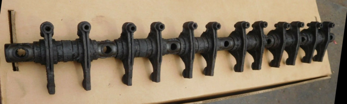

Pre '80 /6 with adjustable rocker arms (I should say, also needs to be cleaned). There are a couple of different versions but differences are minor.

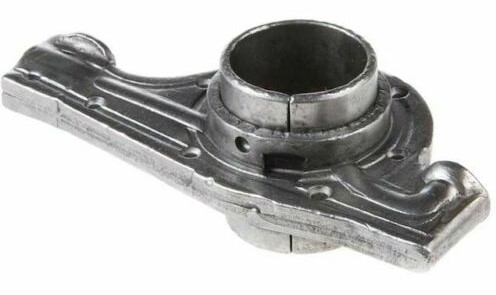

This is a '80 and up non-adjustable rocker arm (looks somewhat similar). You can see the internal oil passageway cast into the part.
Some part stores say this rocker arm will fit.
It might fit (never tried), but there is no oil passageway to the lifters (so DO NOT try to use).
