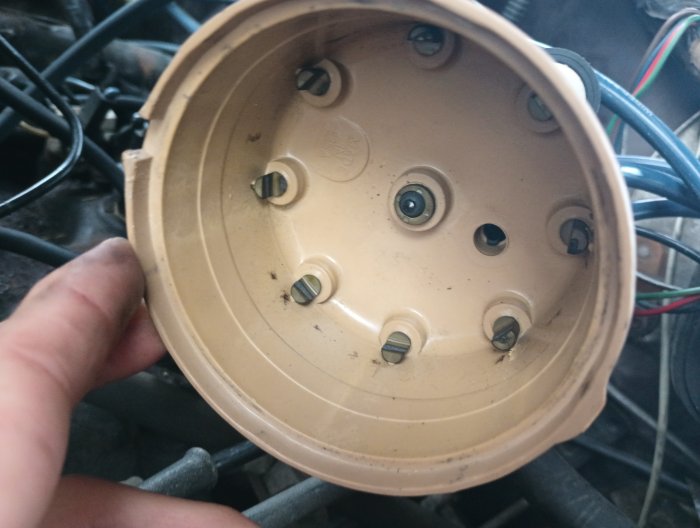

in my check... boy was my distributor cap dirty.... Spark plugs were probably just meeting their replace date. in 5 years i had only put 20k miles on her. had just picked up some RN12YCs. there were no obvious misfires that i could hear but she always hated hills. was a slight delay in acceleration but most every car i've driven has this delay carbureted or otherwise. maybe my family are just terrible car owners?

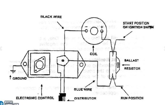

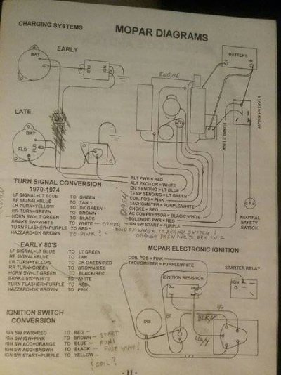

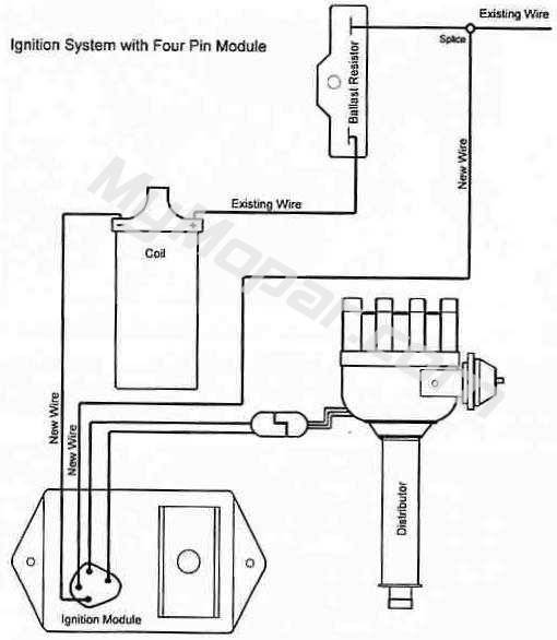

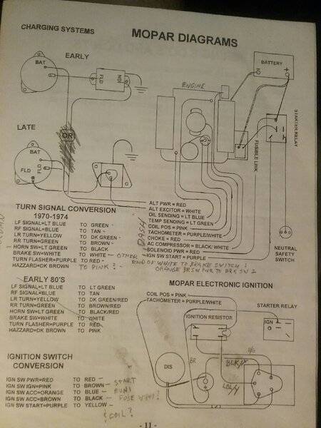

for now i am enjoying Christmas with my family. i likely won't hear from the shop till after new years. I appreciate the diagrams AMC.

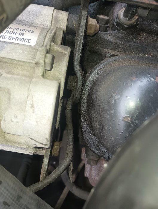

well, before i had the car towed away i was going to have this wire replaced. negative battery terminal to the rear of the alternator? couldn't figure out how to unbolt this. shop "says" they tested it but i kinda don't believe em.
i'mma be mad as hell if the guy calls me and says its this. how would i get this anyways? is the end of it like a fork so i could just pull it out or is the end like a circle so i'd have to remove the whole bolt. not a lot of room there.

Unless someone has loosened it that wouldn't be the problem.
Thst looks like the air pump. You'd pull the bolts and either flip it but or remove it all together and push it aside to get behind it.

That cap looks horrendous. You have spark jumping everywhere. Replace the plugs wires and cap and rotor with GOOD stuff and check everything again. It will probably start, but do it all. Timing carb adjustment and gap your plugs before they go in. Don't trust what they give you. I am surprised that ran

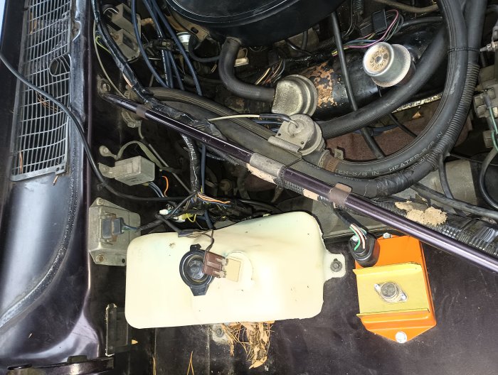

when the orange box is put in, the original ignition box on the firewall is dead right? i
What box on the firewall are you referring to? The voltage regulator?
And I agree with @Ele115 you have spark jumping all over. Contact @Halifax Hops for the right stuff. There are differences in rotors and caps and the aftermarket stuff can really be hit or miss. All Hops does is Mopar ignitions. He's THE guy for this stuff.

You have to really watch the parts especially the rotor. I have seen a few where the rotor has the little contact about 15 or more degrees off. I have seen them really lose. You don;t want aluminum contacts. If they aren't gold, forget it. It's getting really bad with the parts.

Name brand cap and rotor are uaually pretty good and better then what you have on there now.
Your orange box is on your fender I thought I saw in one of your pics.
The wiring won't suddenly go bad unless it was damaged or a connection got loose, both those are pretty easy to spot - look along the wiring that was added with the conversion. You can follow the diagrams posted earlier and use a volt meter or test light to make sure it's getting power at the various spots.
