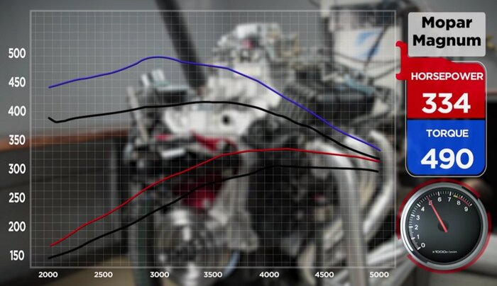

Here is the screenshot of the end result!
7,084
Pretty darn respectable, especially the torque.

1,669
Compression aside, look at that graph. The peaks numbers aren't nearly as eye opening as that sheer amount of torque from low rpm all the across.
This is where stroker motors shine. I don't think I'll ever build another stock displacement engine.
