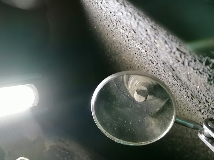

Kind of a dumb question, and don't mean to doubt anybody but, on the shift shaft seal, it didn't get put in upside down by accident? It can happen although I've never done it far as anyone else knows, LOL.

I guess the main leaks are the pan gasket and the shift shaft sealing...
I am pretty sure the shift shaft sealing sits in the correct direction. I try to upload a (bad) picture. But still I am not sure if it was renewed at all or if it was renewed without cleaning the shift shaft...
