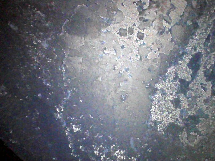

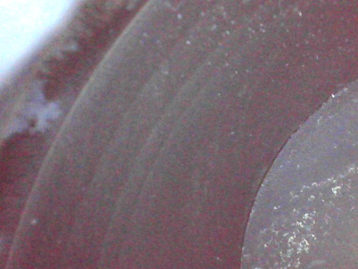

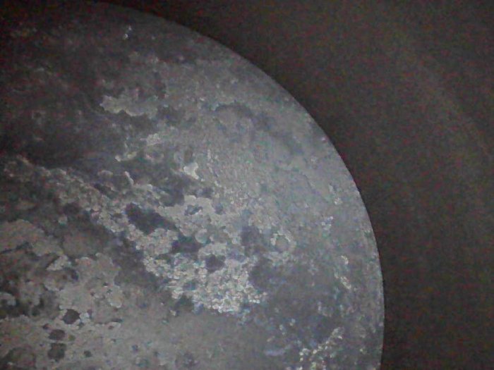

PursuitSpecial
Mar 18, 2023
61
44
North Carolina
I pulled plug #3 and took some pictures of the piston with a bore scope. It's pretty dirty in there and the piston looks like the surface of the moon, and there looks to be some loose carbon. Not sure if that is causing the detonation or if the detonation is what's knocking the carbon loose and marring the piston.
