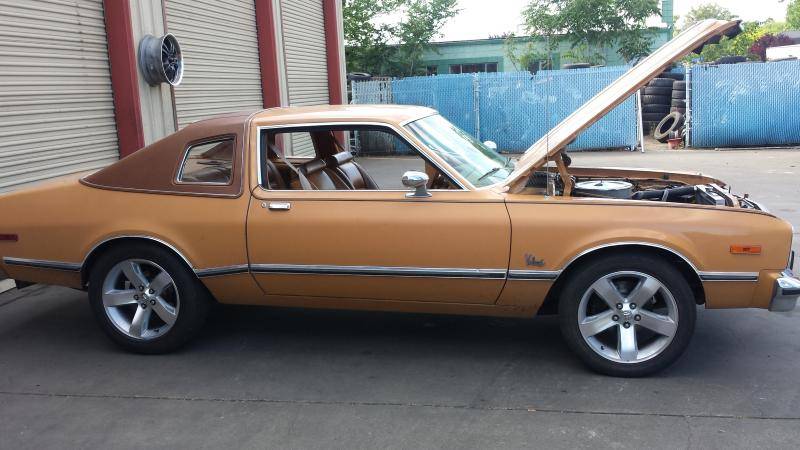

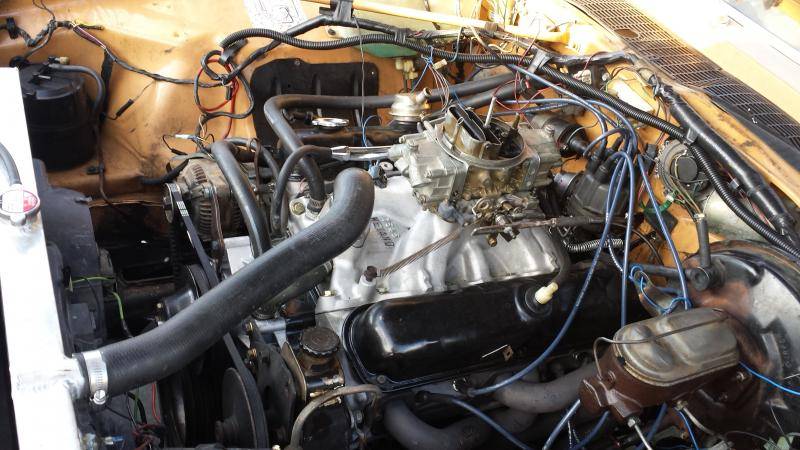

my 518 is non lockup. im running a factory 727 hi-stall thats
been loosened a bit. i was going to run a set of indy-x heads from hughes but the aluminum heads were more affordable. i have like $1300 into these heads.
76volareman
Oct 12, 2013
62
3
Northern California
runs better with this setup.

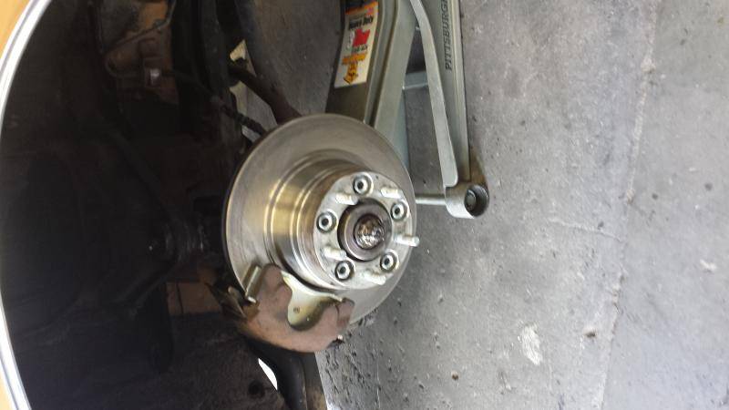

also swapped on the cordoba 11.75" rotors. stops well with the jeep cherokee rear discs too.
also i put 3.55's. and a trac-loc in it. with the 235- 55-18's in the rear it can use more gear but for the street its good. i run 235 -50-18's on the front on 2012 challenger wheels and 1" spacers.

I got them from http://www.ebay.com/itm/Mopar-Chrys...Parts_Accessories&hash=item27e348e9b2&vxp=mtr ignore the parts description about the 1.62 exh. seat and magnum stuff. I tried to explain to them to no avail the dif, between Magnum and LA.
then get your choice of std. length small chevy 2.02, 1.60 valves and a set of retainers and springs with around a 1.8" installed height and your set. Always measure your installed height before you order springs first though. don't forget a spring cup or just a shim like I used. I got the best rocker arm wipe with no shims under my shafts with 273 rockers. The oem pushrods worked too.

got some 1.6 rollers from prw. once set up with correct alignment and some hughes make it yourself pushrods. work really well. now the car is like a light switch from 4000rpm on. i really need a good 10" converter.

so after months and thousands of miles of running these heads have not failed yet. i wouldnt recomend the cnc'd versions for under a 408ci engine though. my bottom end is soggy even with 10.2-1 comp. and a fairly mild cam. also my headder flange overhangs the exhaust port outlet of the head causing wierd reversion that i cannot seem to tune out. also not an issue on the non-cnc'd heads. oh well. live and learn that bigger is not always better. im getting a set of indy x heads soon. lol.
