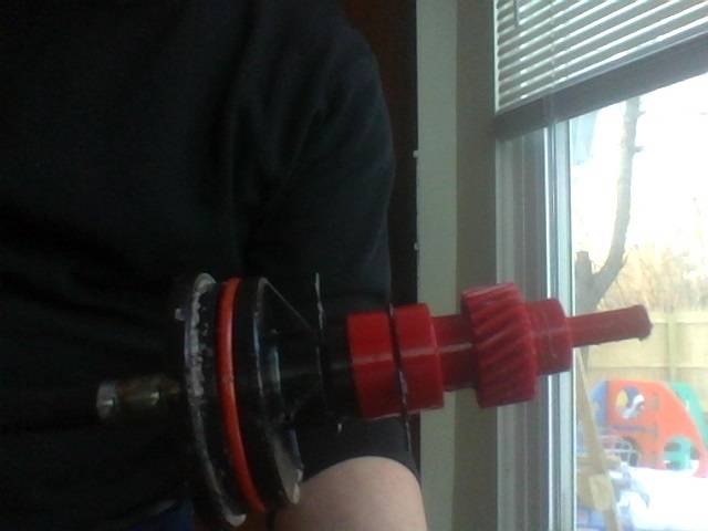

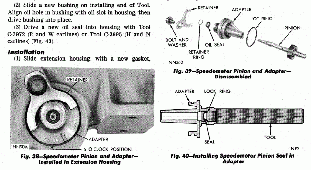

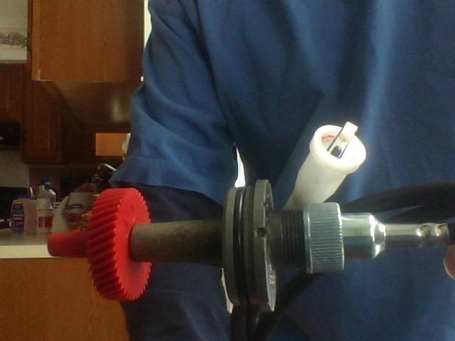

I 've posted these pics before when I swapped mine out
Stock what our FMJ cars came with
That is like the diagram in the above thread

Exactly as Slant6billy has shown (he beat me to additional pictures). I like the second picture, showing both ends of the cable. The first picture cable metal end is rather plain looking (not shown).
Those first picture speedometer gears are not easy to find.
