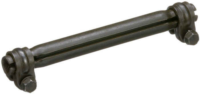

- Last tip: The factory tie rod sleeves are inexpensive and work well for most drivers. That said, the open nature of the tie rod sleeve:
Allows water to collect – which allows rust to happen.
Also, that same design has a lot of flex when driving hard (lots of hard/fast turns). There are videos of people attaching cameras to areas and making hard turns and your jaw might drop after you see just how seeing much they flex under hard usage.

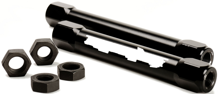

This style (any brand) doesn't have the flex and doesn't allow for moisture to accumulate.
The only downside I see is dissimilar metals (steel and aluminum) can cause corrosion to occur where they thread together. One solution is to use a dab of anti-seize compound or maybe Loctite blue (or something).

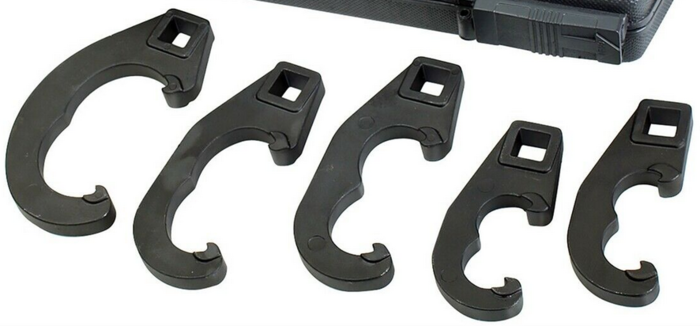

They also make an official tie rod adjusting tool (for using the OE style sleeves):

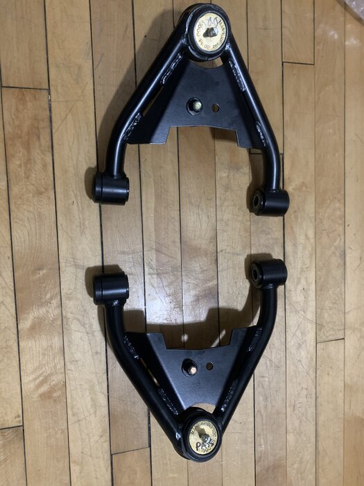

New tubular upper control arms shipped today; finally.
Matt also let me know, torsion bars are still a ways off and their only putting together a production/waiting list at the moment for the next run.
Also; they have 2, that’s right 2 complete sets of the notorious OEM torsion bar ends (that are no longer made) and bushings...$600 a set for anyone interested.

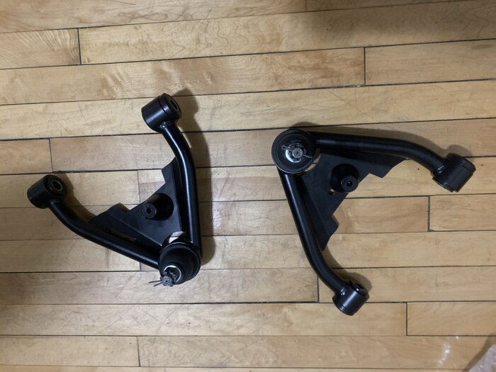

New control arms got delivered this morning (I unfortunately still have 8.5 hours in my 12 hour shift at work) so, car should be back on all fours and ball parked this weekend and on a rack for complete alignment come Monday; luckily my buddy just took over a, Midas and is gonna give me that “homie hook up” special.

I actually emailed them yesterday asking just that. Still waiting for an answer. I’m also a little disappointed that they came pressed into the control arm already.
2,991
I was wondering about those bushings being pressed in already since they have to be pressed in AFTER the shaft is put through the holes. Odd..................
Camtron
Apr 25, 2019
2,332
1,905
US
Yup, meanwhile my cars been sitting for two weeks waiting for them to arrive and I’m still waiting on a response from them.
I’m not very thrilled about it after handing over $490.
