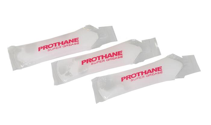

I recommend lubing the bushings before installation with grease made for urethane to prevent squeaks. Something like this:
Prothane Motion Control 19-1750 Prothane Super Grease | Summit Racing

Getting that, prothane lube took a few days, since I ordered it over the weekend.

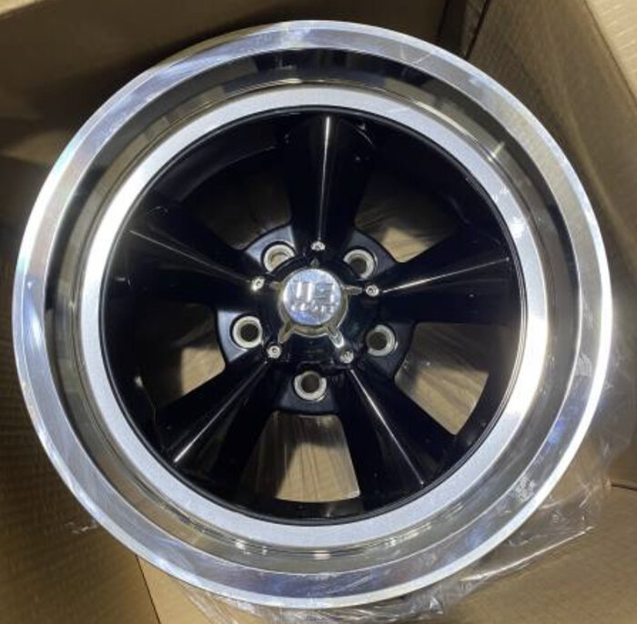

Those would compliment your car nicely. What size rim and tire combos?

Rims are 15x8, thinking 255/60/15 all around.

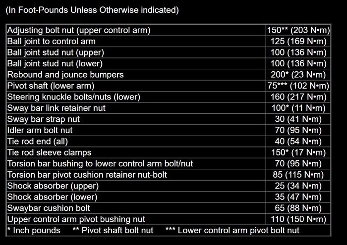

Anyone happen to know the torque specs for the control arm pivot shaft nuts?
I feel like it’s 80ftlbs for the ends (and those get torque when the cars on the ground at ride height) and 120ftlbs for the two in the middle of the shaft.

The Dippy site says 110 ftlbs for the ends (torque them at ride height as you wrote) and 150 ftlbs for the adjustment nuts (center ones).

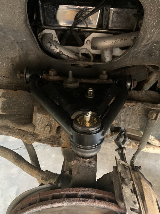

Ball parked the alignment late Sunday night and drove the car to work yesterday. Man, what a difference.
It’s hard to describe the change in feel but, there’s so much more confidence when cornering at regular traffic speed.
I had installed pivot shafts from, Rare Parts a couple years ago and those certainly helped; but, pairing them with the tubular upper control arms is an absolute game changer.
Car should be on the alignment rack first thing tomorrow morning to really get things dialed in.

Pulled the trigger on the wheels, Got a couple 255/60 tires on order.
Since my rear tires still look about brand new, I’ll just rotate them up front and throw the slightly bigger new meats in the back.
So I’ll be running 245/60 front and 255/60 rear.
