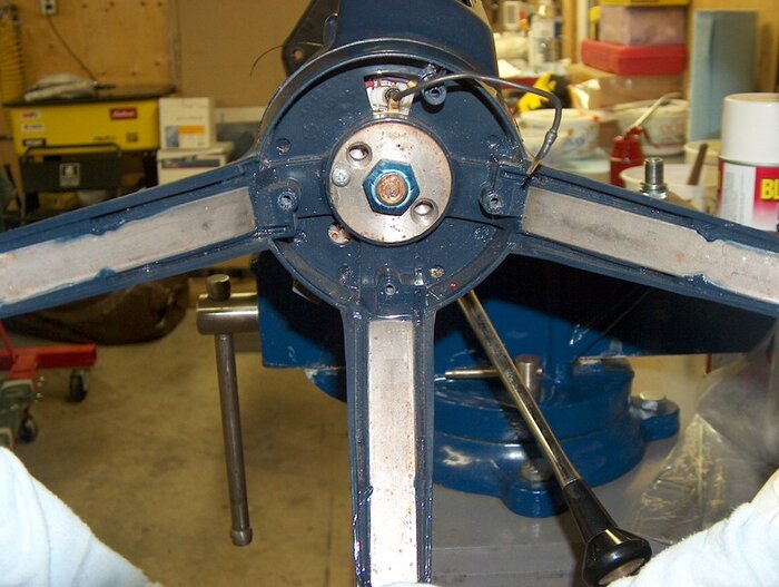

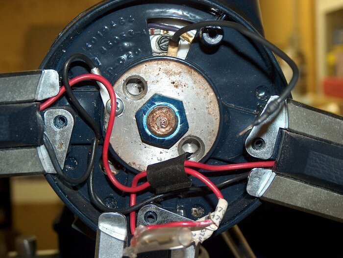

No detailed write-up here, but a couple of photos.
So basically you'd need to remove the horn button assembly, then you have some trim to pull and you're there.

Ahh...sorry, I used these pics because when I took them I had the column out of the car and it was just easier to document the build that way.
But...even when the whole column is installed in the car you can certianly do the same. This means you do NOT have to remove the steering wheel itself. In fact as you see in these photos to wheel is still attached to the steering column (the spline and the blue nut are visible in the middle), and the whole horn assembly has been removed.
That's all you need to get to in order to fix up any horn contacts issues.
Now if in addition to the horn fix you are also looking to replace/fix any turn signal issues, at least on my coupe that would require the steering wheel to be pulled.
