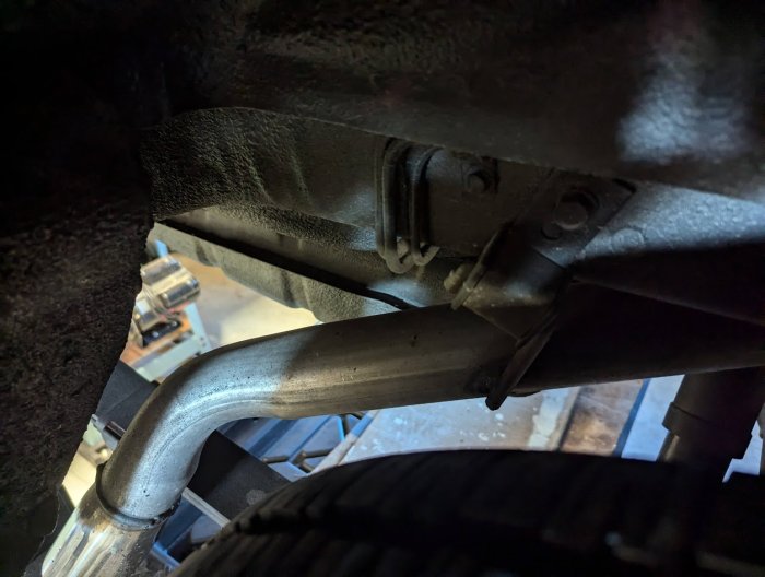

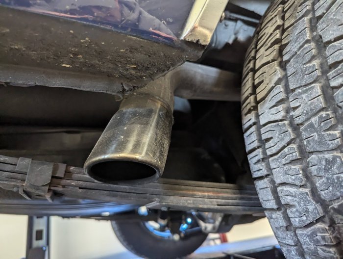

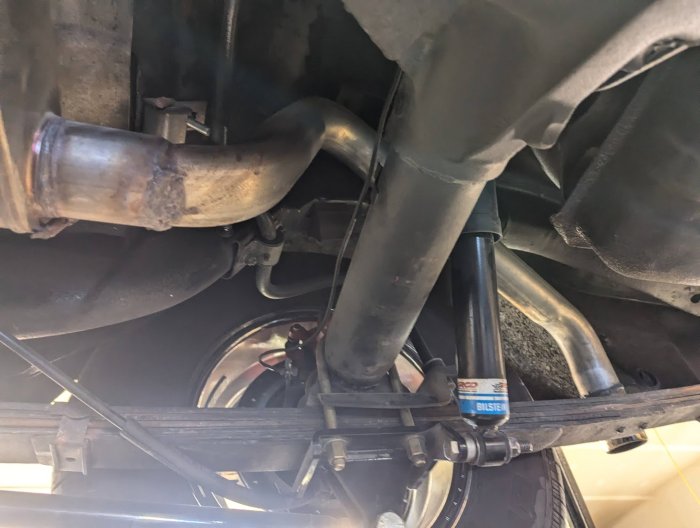

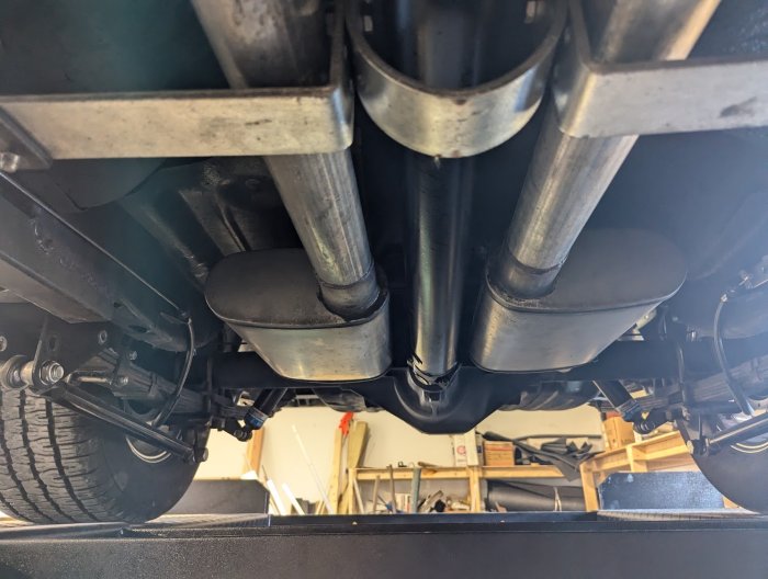

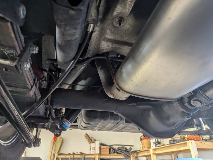

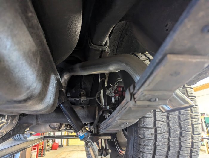

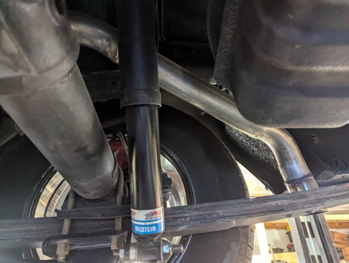

Thanks for the exhaust routing and size feedback. I need to check the drivers side clearance for the 'over the axle / out behind the tire' exit. The rear anti roll bar maybe a conflict. Truth be known I would prefer dual exhaust as opposed to a single big pipe.

Here are those photos of the exhaust routing behind the tires. Board doesn't allow for sending photos in PM.
