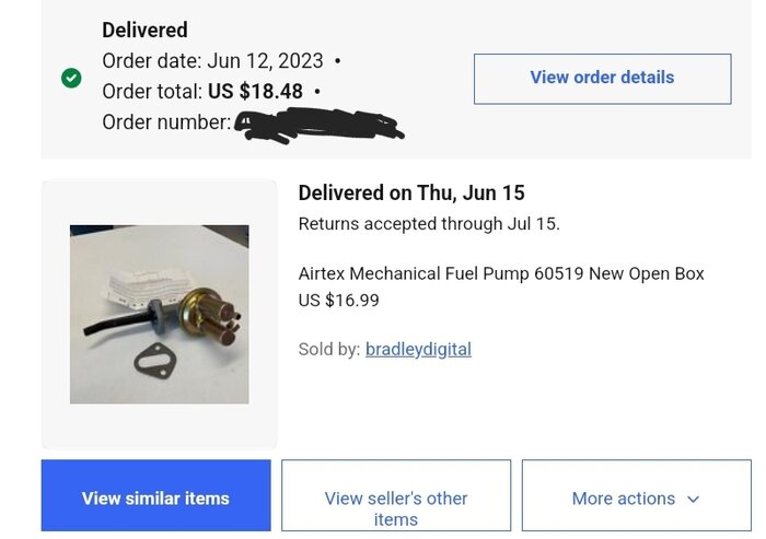

AMC Diplomat
Feb 14, 2023
1,470
668
NY
Where are you finding mechanical pumps for less than $20? I paid almost $30 for the last one at an Autozone store. Regardless, it's been in the car for about six months and doesn't seem able to deliver the pressure it did when it was new. I'm just tired of changing out mechanical pumps and want reliable, consistent fuel pressure.
Ebay
Make offers or let the sellers send you an offer. You'd be surprised how many people want to get rid of this stuff
