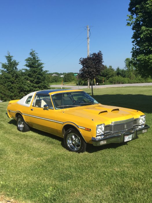

Hey guys. Looking for some brand suggestions/websites to get a front end rebuild kit and a set of shocks for my 77 aspen? Just finished a mild built 383 big block 727 swap on my aspen and I’m now focusing On the suspension aspect of my car Any thoughts? thanks in advance

Gorgeous car by the way.

Thanks guys for all the great input and compliment on the car I’ve had it since I was 14 and just kept working on through high school and kept keeping the improvements coming! Firm feel sounds like the site for me then, do they offer the steering box upgrade? I think the control arms and torsion bar upgrade would really benefit me as well. I noticed you practically can moving the steering wheel with your small finger lol Typical old car steering so I would probably benefit from the steering box upgrade! Should I get the shocks from firm feel too or what do you guys run in your cars for shocks? Thanks again in advance

I absolutely love that car. Need more photos!

I would like to see a few underhood pictures of your big block install, whenever you get around to it, please.
