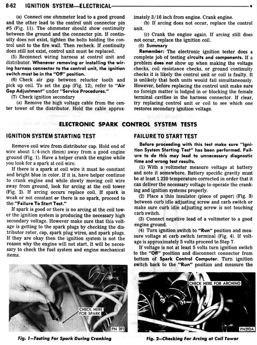

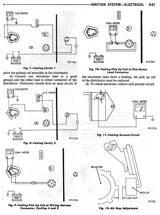

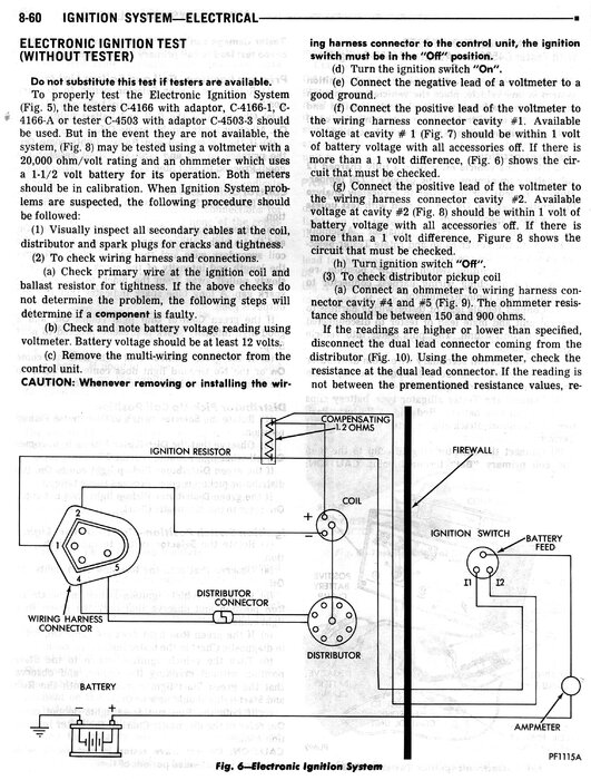

Here are a few more FSM (1980) page scans I had previously saved up, given that one never knows when the Ignition system will require some troubleshooting! lol

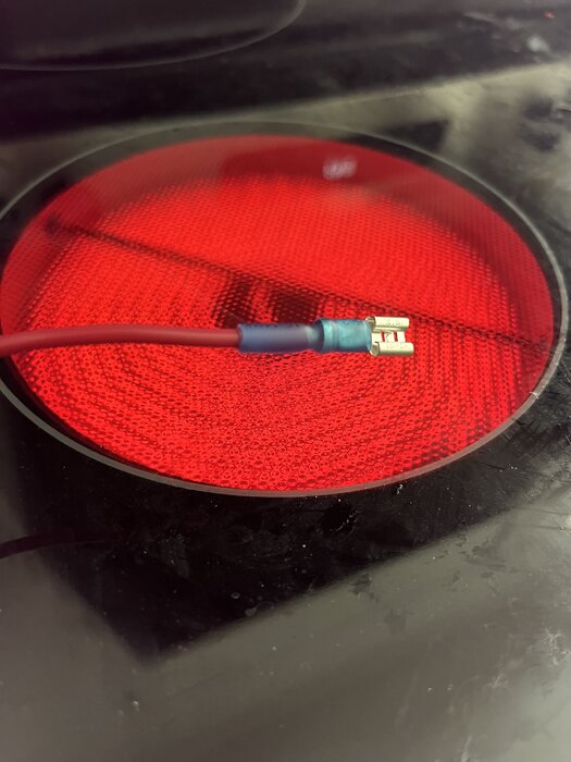

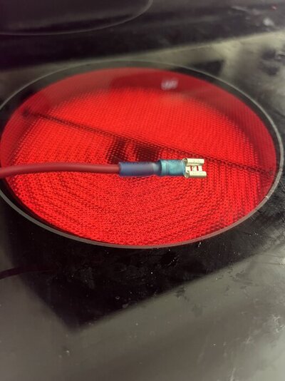

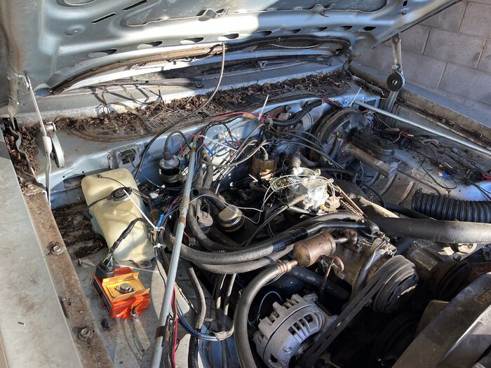

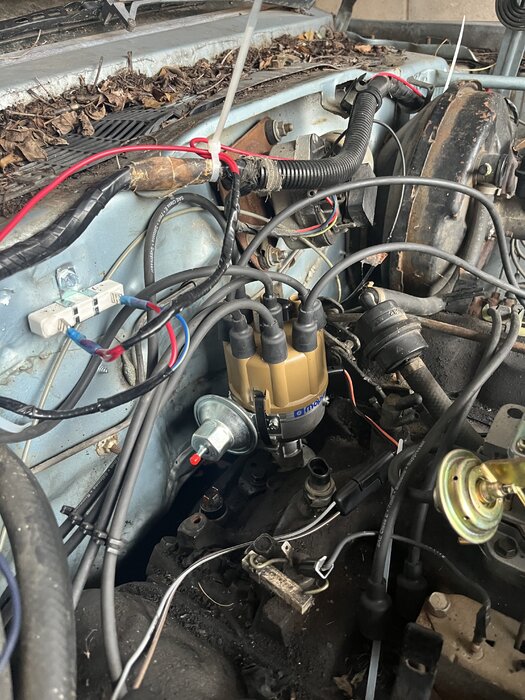

Well, the rewiring part is done. The battery is on a charger now, so after I swap the distributor and put the battery back in, we'll see if it fires up tomorrow.
Also, since I didn't have a lighter at the time, I got creative with the Starter Relay Bypass Wire's heat shrink. XD

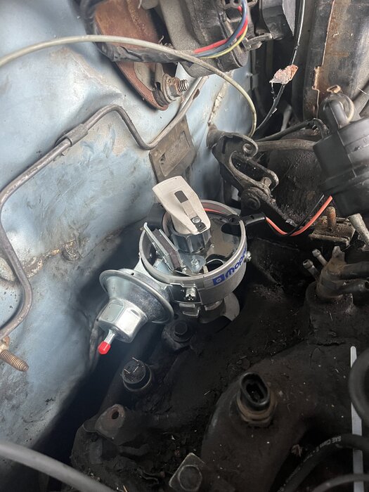

new Distributor is officially in!
now I'm just making some bypass wires for the sensors now that the Lean Burn is out.
Oil pressure light, water temp. etc.
