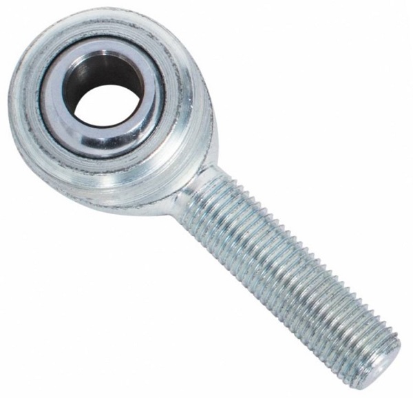

I kept snapping those bolts even when I had an aluminum headed small block with no AC. Honestly, it's a garbage design. Not only do we see grade 8 bolts snapped, but also torsion bar bushing ends ripped apart because of it. The end links should have been rods with heim joints or something like that.
1,494
Metal heim joints do not do well for street usage. Racing only - yes, but not for the street.

I ditto the heim joint on the street thing. Certain newer vehicles now have heim joints in the rear suspension (Taurus and last version Explorer for example) at the knuckle to upper arm connection. At first glance they look like a standard suspension bushings but internally it is a heim joint. Even though they are weather sealed, we are forever replacing them due to becoming loose. Not just a little loose, a lot loose. Wouldn't be so bad except they're pressed into the rear suspension knuckle and are a really big PITA to change. When I say press in, I mean PRESS in. I swear the outer shell is 6 mm larger than the bore it goes into. Depends on the type of driving and where the driving is done but life expectancy is anywhere from 30,000 to 100,000 miles.

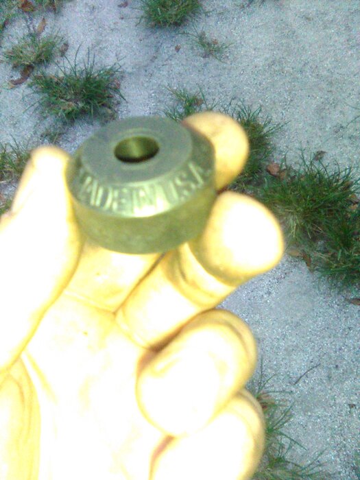

I'm going with the eBay ones, I'll have the money on Tuesday, hope they'll still have them. I don't trust Chinese parts at all, I was surprised to see that the Napa bushings for the sway bar were made in the USA
