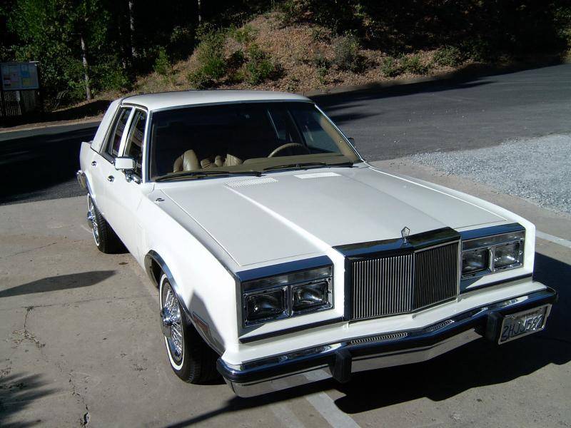

I recently purchased a 1987 Chrysler 5th Ave with only 37K from the original owner in California and then drove it home to Idaho. The car is exceptionally clean and runs and looks excellent both inside and out. It was well maintained and was always garaged.
I just changed the oil last week and thought the best thing I could do was to upgrade to Mobil 1 full synthetic extended range......wanting what I felt was the best way to baby the car.
Found this forum tonight and really feel I found a great resource but was surprised to see a couple of postings sharing that Mobil one should not be used, and I should have stuck with a high quality 10W-30 conventional oil.
This car is leak free and a real survivor so the last thing I want to do is create a problem.
SO.....what does everybody think? Am I ok? or should I go change this quickly? It has only been driven about 20 miles with the synthetic.
Thanks for your wisdom in advance-

That's a gorgeous Fifth.
If it were me.
I'd change it immediately to conventional 10W 30. New filter too.
