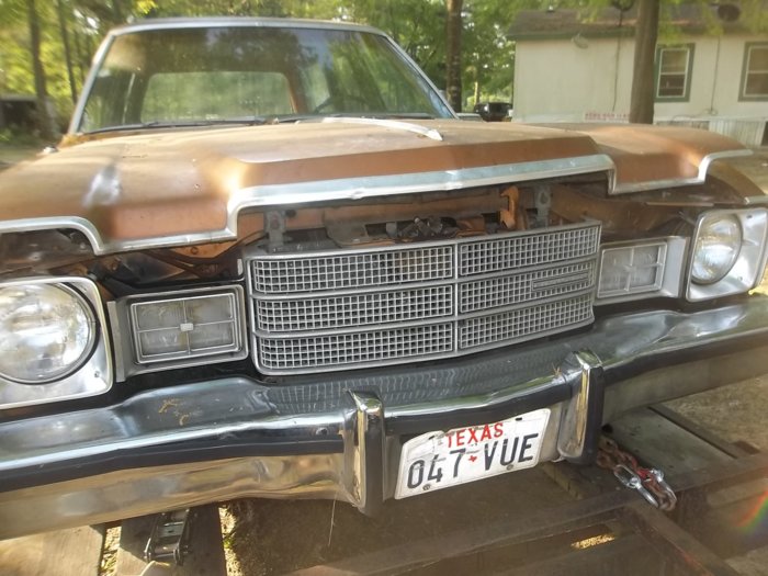

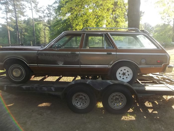

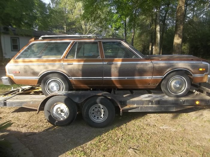

Is the rust you have on the front fenders, only?
Looks like a nice find. Other than the woodgrain aspect, I’m almost jealous.
