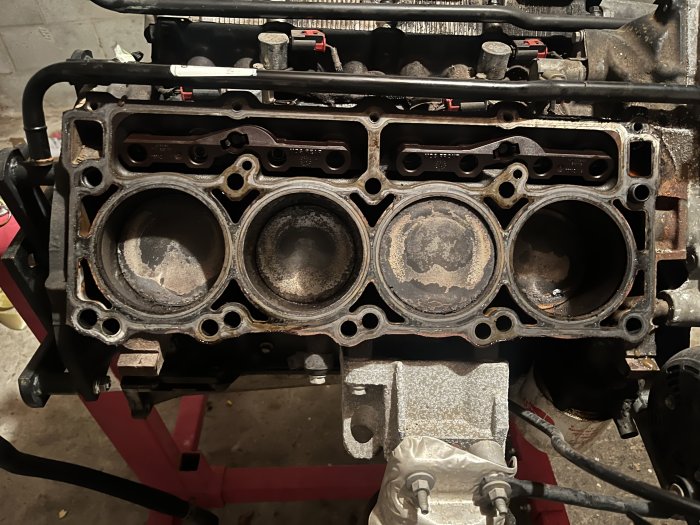

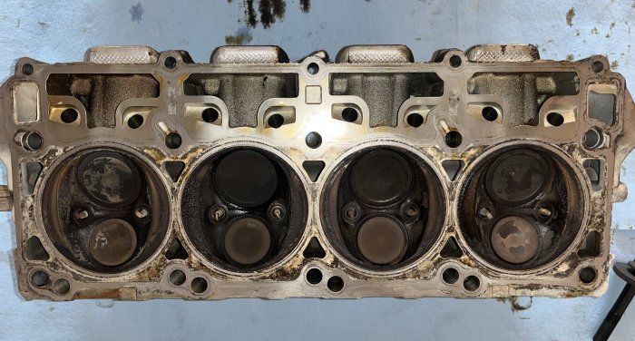

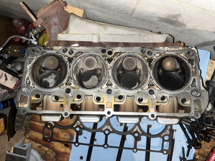

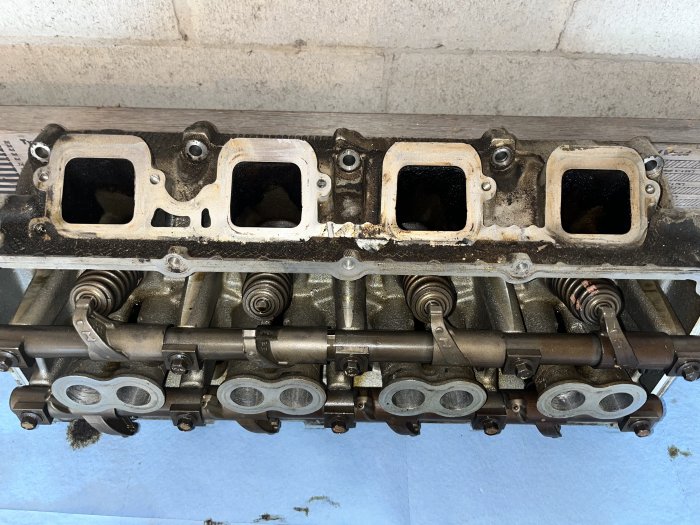

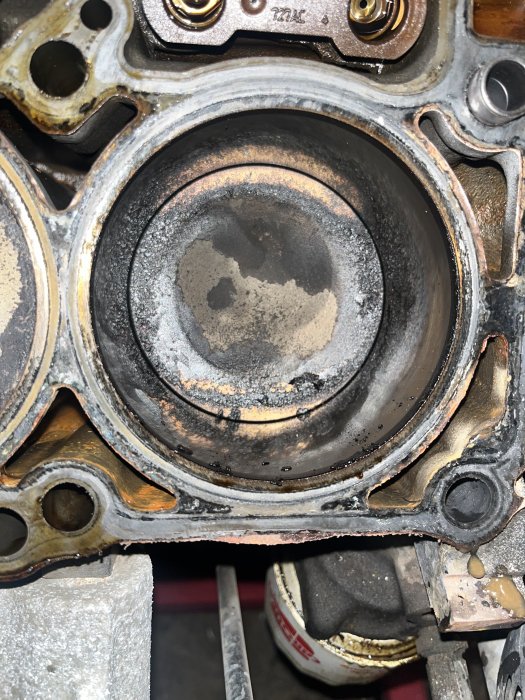

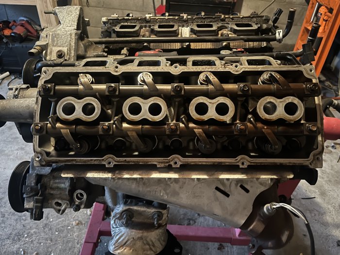

After 4 months, I’ve finally started the teardown on the ‘13 5.7 Hemi that I got. So far it’s just the passenger-side head that’s been pulled off.
The closeup shot is of the #2 cylinder.

Thankfully it does not seem to be the case. If anything is wrong with the others my plan is to get a set of the Pre-Eagle pistons.

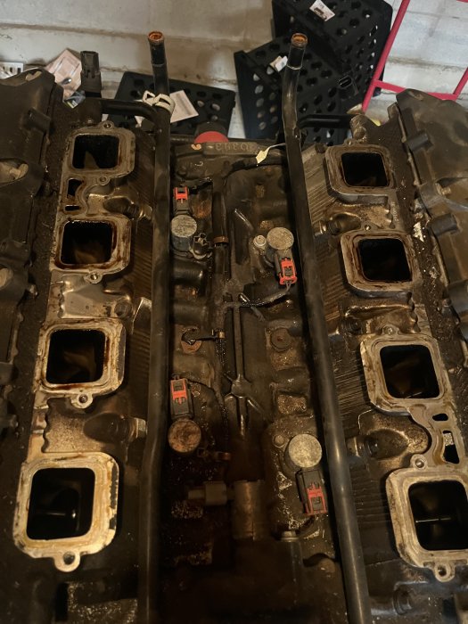

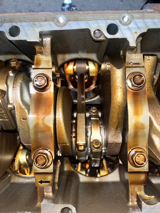

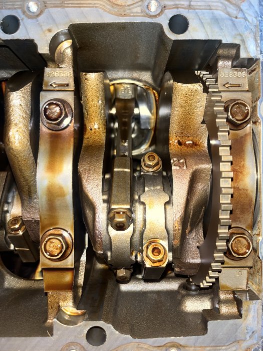

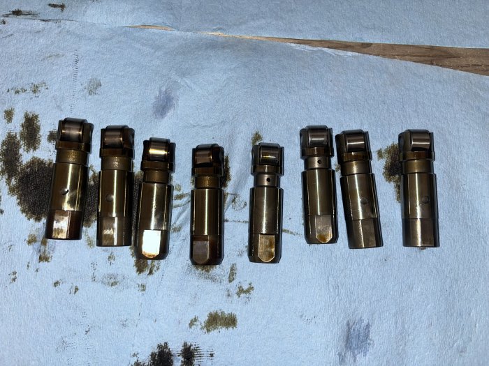

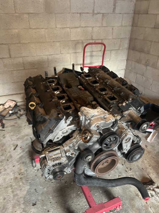

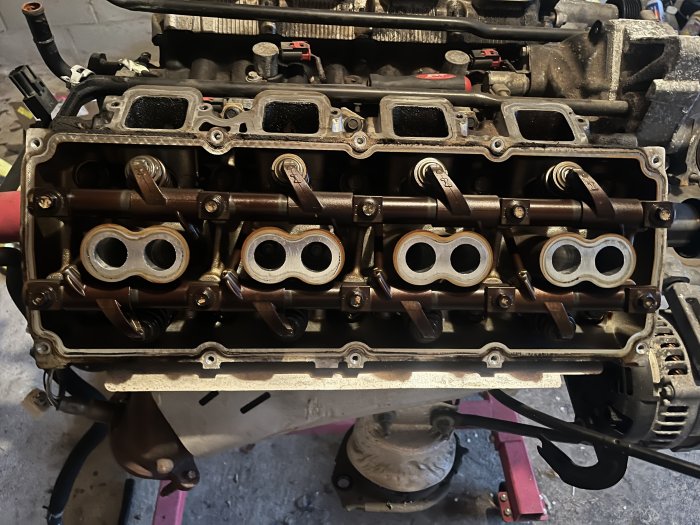

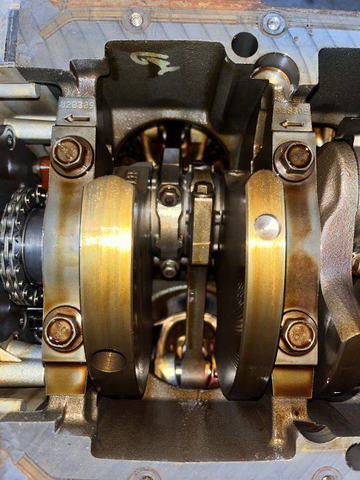

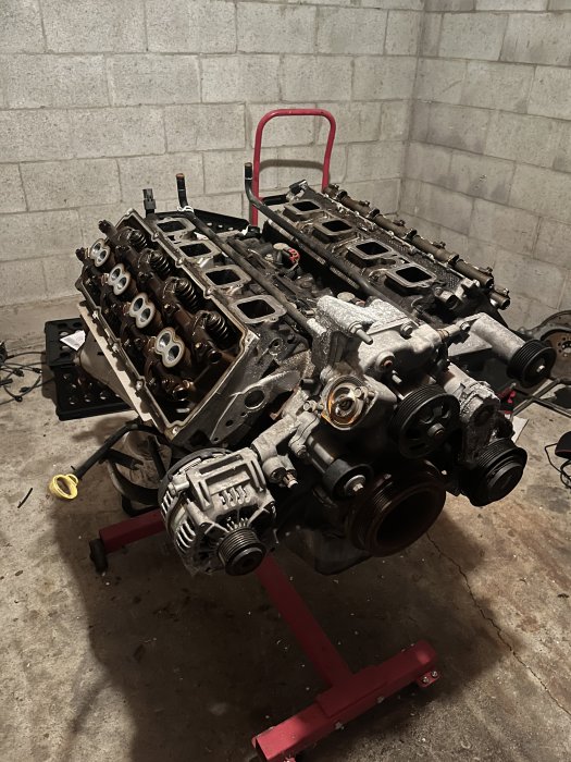

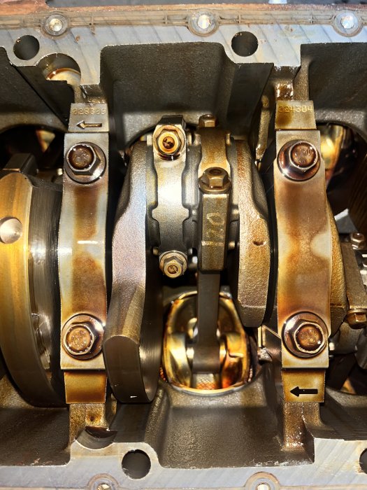

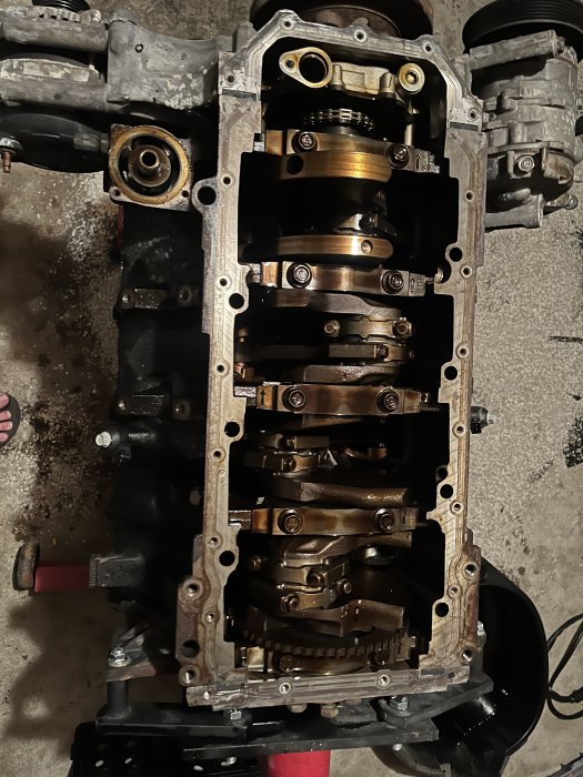

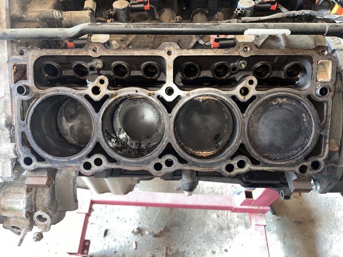

Well, we’re moving along. Driver’s-side head is now off, as is the oil pan.
Good news: all 16 lifters look like they’re in good shape.
Unsure about a couple lobes on the cam though. Might need a set of rings too.

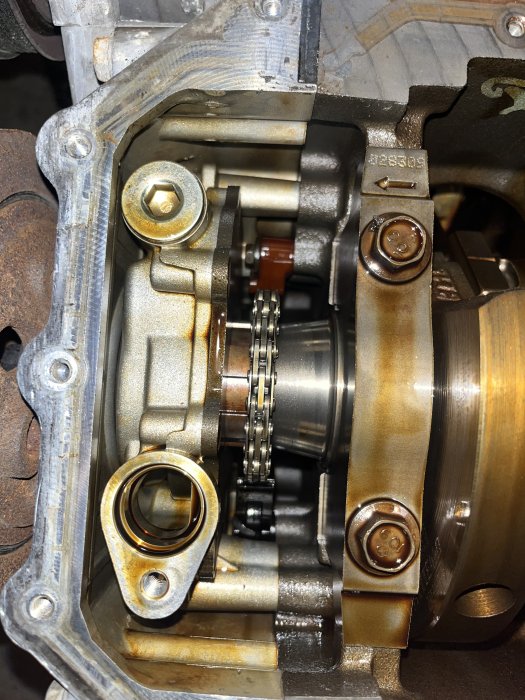

Next, I need to either find a big enough pulley puller, or get a spacer or something to fit on the crank snout so I can get the pulley off and the front cover. EDIT: Thank goodness for YouTube, It looks like I wasn't grabbing the right spot with my puller's claws. If I get up early enough tomorrow morning I'll have the front cover off.

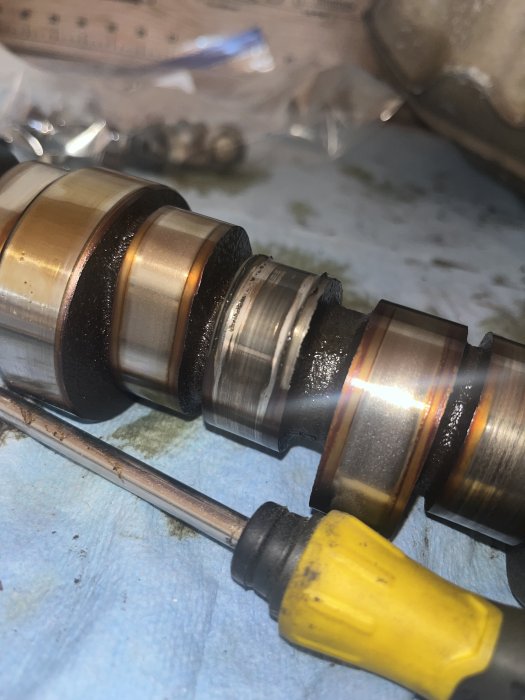

And…it looks like I need a new camshaft. Whatever 300 this engine was in originally was going to be off of the road within a couple months of the accident that totaled it anyways.
Now…I’ve gotta figure out what to choose for a camshaft.

Not surprising. These things have a reputation for eating camshafts. You were wise to do a complete a disassembly rather than just tossing it in.

Cams seemed to a common failure on them at the shop when I was a tech. Never was sure if a roller lifter that wasn't rolling anymore ruined rhe cam, or vice versa. If it's any consolation the "almighty LS" does the same thing, only more often. On those the cheap ass lifter guides break, and the lifter turns sideways. Cam lobe failure soon follows.

From all the research I've done, it looks like it's a combination of the metal of the lobe, the needle bearings on the lifters being too small, and the grade of oil used. It could also be the original oil pumps aren't pumping enough volume at idle for the ones running very long idle times.
I do plan on getting a high volume oil pump as well, probably one of Melling's.
