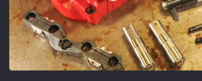

I did wind up bookmarking a couple Engine Masters builds from the 2010's, and one of them used modified LS lifters. The roller bearing size is identical, it's the upper section where the link bar portion is what they modified. They also modified the cassettes that hold the top of the lifters in line so they could use the LS lifters in the Hemi.

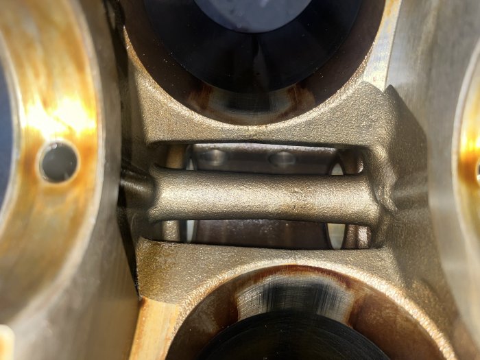

Seeing as the main oil galley is literally that center tube, it shouldn't be too huge of a deal to get some oil squirters aimed at the camshaft.

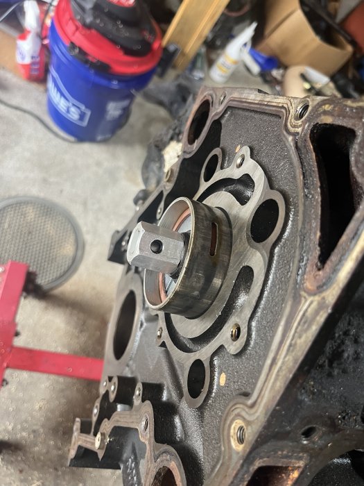

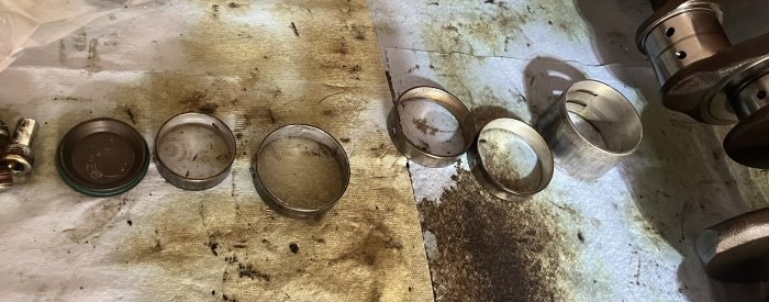

Well, slight update: I wound up going to TSP for the camshaft & gaskets too. Ordered cam bearings & the installation tool. I didn’t want to pay the $225 that the machine shop wanted to remove & install the cam bearings. I’ve found a couple videos on YouTube that were for cam bearings on the 5.7’s. I think I can do this.

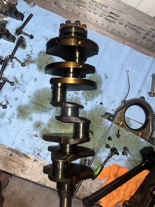

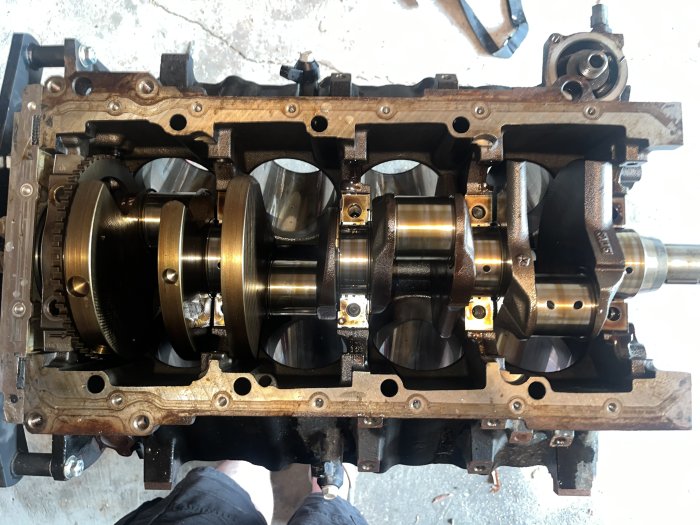

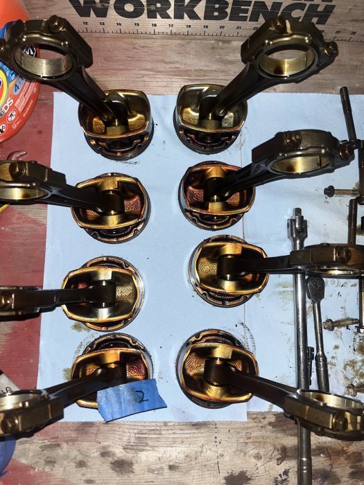

Looks like I get to spend part of the weekend cleaning the rotating assembly and polishing the crank journals.

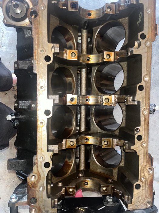

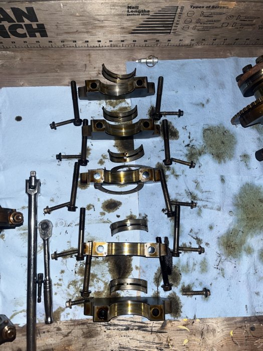

well, we've finally gotten to the end of the bottom-end teardown.
The cam bearings are now out, and the block goes to the machine shop tomorrow for it's cleaning.
