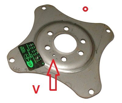

The drain plug makes it easy to line up the torque converter to the flexplate.
There is a small hole where the flexplate to crankshaft bolts are at. The drain plug goes opposite of that small hole.
A random picture I swiped from internet
If one really looks close, there will be a “V”, on an “X” stamped on the torque converter. That stamp lines up with the small hole in flexplate and is opposite side of the drain plug (if present).
