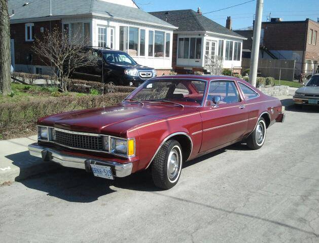

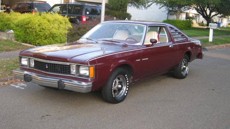

My car looked just like yours when I got it,put a set of rims on it black out the grille and ditch those wheel lip mouldings,I'm sure the wife will like it even more.
Looks sweet.....
Curious though...
Your name is 80aspen but that's a Plymouth
Did you convert it?
That is a nice ride 80aspen!

I will be converting it to an Aspen when I restore it.Been collecting parts for about 10 years to totally redo the car,I have about 85% of the items I need,Lots of NOS stuff,will be doing some custom things.I am very close to starting the project.

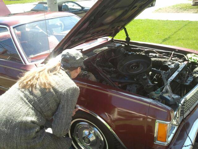

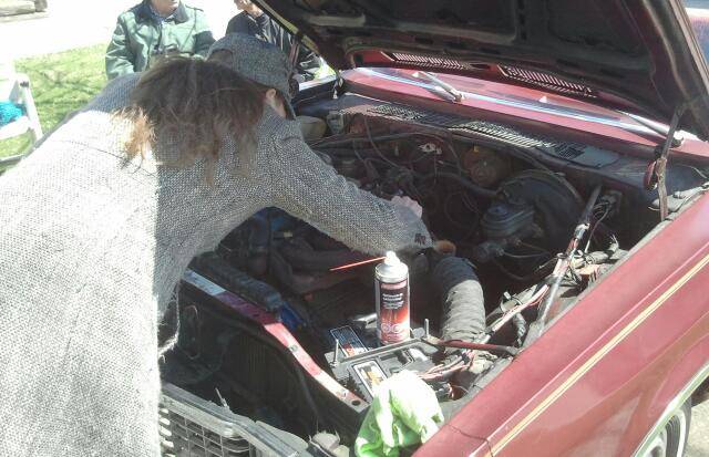

Finally had good weather today so we went to my buddy's place to investigate the carb.
As suspected...absolutely caked with crap.
A can and a half of carb cleaner and a lot of scrubbing and she's running a million times better.
Wires are coming Tuesday so tune up is next weekend.

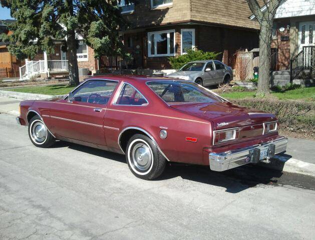

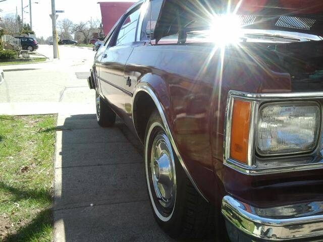

Even gave her a wax today.
I'm one of those nutjobs who thinks cars have feelings.
If I'm right...this is one old gal who's feeling a whole lot better about herself now.
