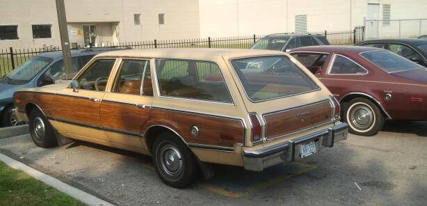

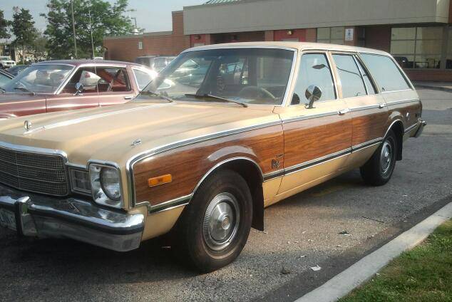

Yet Another Addition....
Well I've pulled the trigger again.....
I've seen this car the Tim Horton's parking lot for a few years now. This nice old gent owns it.
I've struck up many conversations over the years about his car and mine.
I always told him.....if you're ever gonna sell that car.....
Well....I'm up at my trailer last weekend having a beer watching the lake and my phone rings......it's him.
I met up with him and made a deal.
If all goes well I should have it in a couple of weeks......
After he buys a "smaller" car for his wife...who now does the driving due to his age.....
He ordered the car new and ordered it with a 318.
They delivered a slant car and he turned it down and waited two weeks for "his" 318 car.
Two M's and two F's....yikes!
But really.....how could I say no.

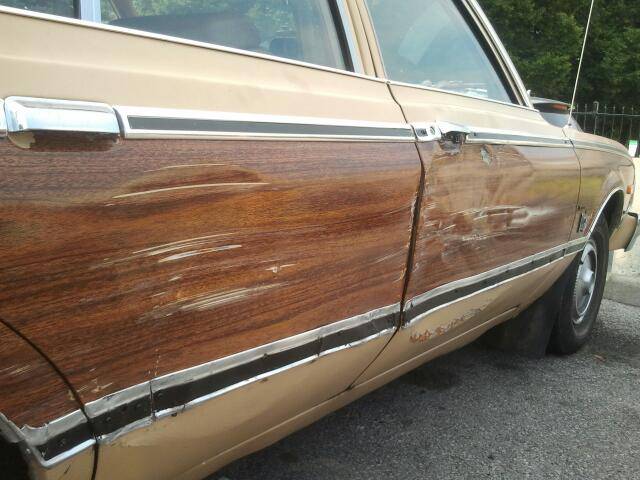

The problem his wife has with the size of the car becomes painfully apparent when you observe the passenger side which unfortunately met a cement pillar of sorts.
