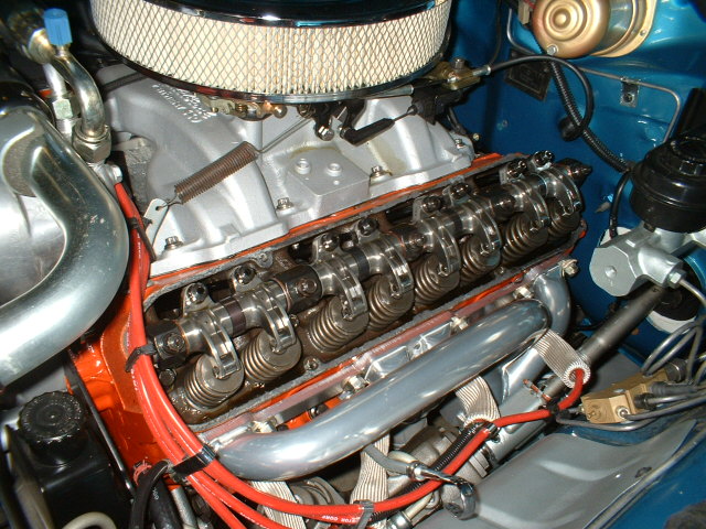

    I think the roller rockers have sort of a "sound" to them as well. PRW stainless roller tip with shaft bushings (not needle bearings).
    Big blocks tend to be noisier, with nothing but a thin piece of tin covering the valley rather than a noise insulating manifold. At least that's the way it's always seemed to me.

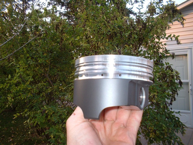

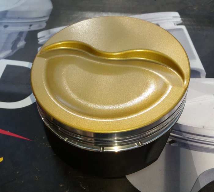

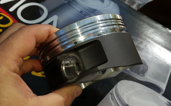

    I purchased two 440-Source 400 block stroker kits (400.470.5060 stroker kit, times 2) a few years back. At the time I had a NOS 400 short block (’78) and a used ’74 400 block (more than 0 but less than 0.010” to clean up). I didn’t want to bore the used block more than needed and didn’t want to bore out my NOS block at all (it is already honed and ready to go, as is, other than having a cast crank and super low compression pistons). I then called Diamond pistons and they made a pair of custom pistons for me to get my compression where I want it at (9.5 to 1), that is also coated. Diamond also sent me 3 spare hockey pucks (well . . . they do look like pucks).
    I sent one spare piston with my used block to a machine shop, three years ago. I hadn’t heard anything so I swung by the machine shop about 2 months later, and building was empty. To date, I hadn’t located my block.
    Sense that time, I found second NOS short block (cast 2 days earlier of my other block, in ’78) cheap. Sense I already invested money in custom pistons, I might have to bore one engine out a tad.

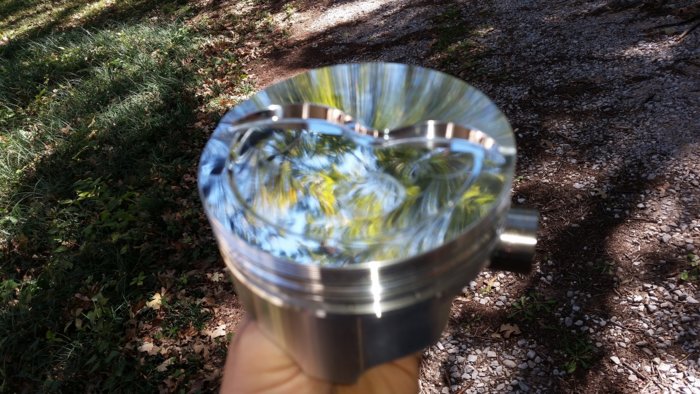

    These are my original 440-Source pistons. They have a cool looking polish to them – but not sure why.
    My Diamond pistons.

    My pistons looked like that when I got them, almost like a mirror on the tops. I sent them to a place that I can't recall right now (think it was in South Carolina???) and had the skirts coated when I built the engine again when it had 100 miles on it. Long story but basically, the original machine shop put the wrong finish on the cylinder walls and I didn't notice it was wrong. Rings never seated and there was gray/silver in the oil pan. I know this because I had the pan off at least 3 or 4 times trying to fix an oil leak (turns out the pan from 440 Source was a POS, replaced with a Milodon and pan leaks gone) I believe it was the rings being destroyed, plus the engine didn't sound right and seemed low on power, along with way too much crankcase pressure. The cylinders needed a 400 stone with a plateau finish. The 1st shop looked like they did a 320 or even coarser, even though I gave them what Total Seal wanted. So,,,,,,,,,,,,,trying to keep the long story short, I sent the block to a different shop and had it honed to the correct finish, which made the cylinders .001" bigger but the coating is .0005" (makes the skirt .001" bigger so, I ended up with the same clearance. Moral of the story, never trust a machine shop that has Chevy on the brain, lol. The second time, the rings seated in about 5 seconds I think(!)
    I remember opening the boxes for the stroker kit and seeing the rods, crank and pistons for the first time and they looked so good, I thought it was almost a shame to hide them in an engine instead of hanging them on the living room wall.:D
    It was the same with the rockers. Too bad they get hidden under covers.
