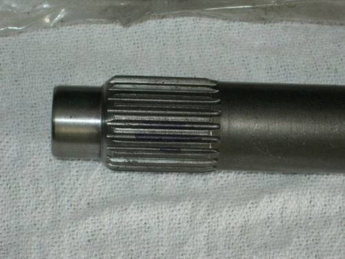

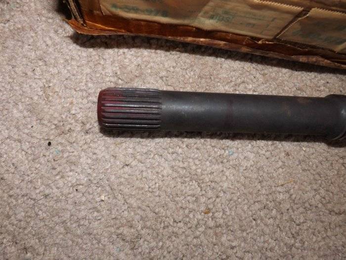

The transmission input shafts are also different in design and spline count.
Non-lockup has splines for about 2 inches from end of shaft.
Lockup’s have a machined end for about ½ to ¾ inch with splines the remaining 1½ inch or so.
904/998/999/500 non-lockup has 27 splines and lockup has 26 splines.
