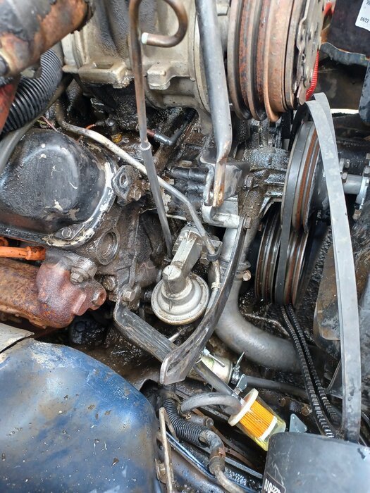

How much slop is too much slop? I'm changing my fuel pump and reached in to poke the timing chain. There's definitely slop side to side but nothing up and down.
It also looks dirty and crusty in there

Maybe 1/2" is OK. However, if it's original, the cam gear is aluminum with nylon teeth (unless it's an AHB), basically a ticking time bomb after this many years. With the amount of crud, and obvious poor maintenance in the past, I'd highly recommend replacing the timing set before it leaves you sitting on the side of the road.
Speaking from experience. Had it happen twice on two different Barracudas back in the early '80's. Driving along just fine and poof, engine dies and cranks over like the plugs are out. On both, the nylon teeth broke off. Well, more like disintegrated than broke, lol.

For sure looks like an original timing chain set up. Probably wouldn’t hurt to replace it. If you do replace it, get a good gasket set and take your time cleaning and installing everything to avoid an oil leak at the front of the pan when you’re done.

Not much nylon left in there. And looks just a liiitle bit too scuzzy to me. I'd open, thoroughly clean and replace with double chain rather today than tomorrow.
Slop's gone when.you're done.

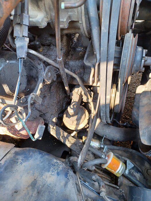

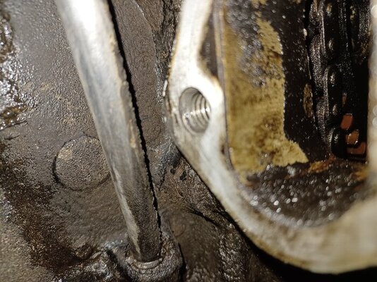

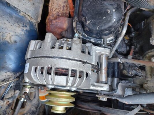

Imagine my disappointment after cleaning the heck out of the area to avoid dirt getting in the timing cover only to discover how disgusting it is in there. 20230617_105915.jpg
This is after cleaning

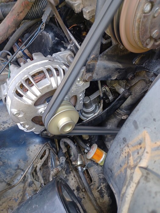

This is live where I'm at right now. New pump is in and this is the nos mopar alternator I picked up when I got the new starter.
There's about 3/8" to 1/2" slop side to side on that chain when I wiggle it. I don't hear it slapping when it's running.
As far as timing failures go, if it lets loose on me are we talking catastrophic engine failure or I'm just broke down for awhile?
2,992
No engine damage, it'll just quit running.
Most if the newer engines I worked on would do mass damage if the chain slipped. GM Eco Tec 4 cyl for example. Replace the rattling chain and guides before it comes apart, about $300 in parts and 4 hours labor. Wait until it quits, $1,000 in parts and 18 hours labor to replace all 16 valves, plus the timing parts. GM 3.6L, $700 parts, 28 hours labor. When the chains go, it's cheaper to replace the whole engine with a Goodwrench reman, about $4,500 parts, 26 hours labor. Why choose those two for examples? Because the failure rate for chains is extremely high and like 80,000 miles only. Damn, I am so glad to never do that kind of work ever again!
Now I'll have to figure out if I want to just send it on a road trip and see if it fails or rip it all down and replace it before I drive it a few hours away.

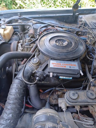

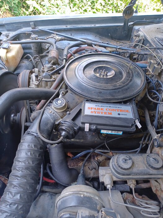

When it was running earlier I could balance a drill bit on the air cleaner. So it runs pretty smooth.
And yes, I know I put the wrong sticker on my reman computer. It was all very boring and dirty under the hood so I wanted to church it up for $8
