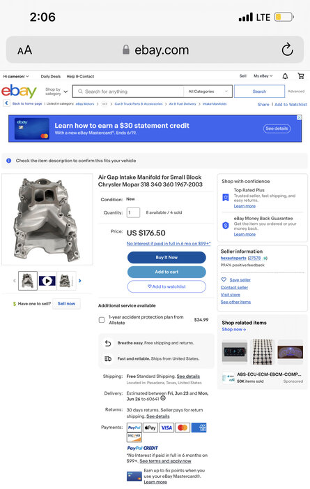

screw a throttle body…let them freedom ponies run. Will work on LA and Magnum engines.
Air Gap Intake Manifold for Small Block Chrysler Mopar 318 340 360 1967-2003 | eBay
