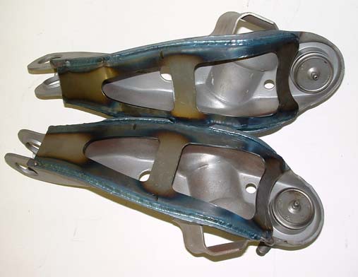

    Robert already mentioned some of this stuff but heres an example of what you might do....you might even go with a tubular upper control arm or add gussets to it also

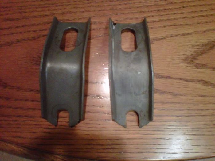

    shouldn't he have reinforcements from the recall on his upper control arm? They attach to the bolts on the bar.

    They are called recall brackets...they actually were part of a recall campaign to help stiffen up the upper control arm rod....

    Those are them. Mine are on my car. I think those should be installed, or something similar fabricated, especially since he will be racing.

    I got an extra set...that was one thing douche bag actually shipped to me after two weeks.....:pottytrain3:
