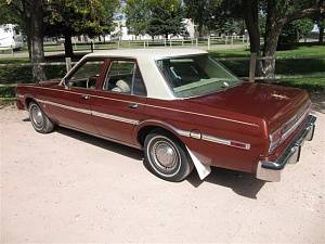

I always put BF's on my muscle cars.
It is a 1977 4 door Aspen with a slant six. It is a long way from Muscle car status. It's my beater.

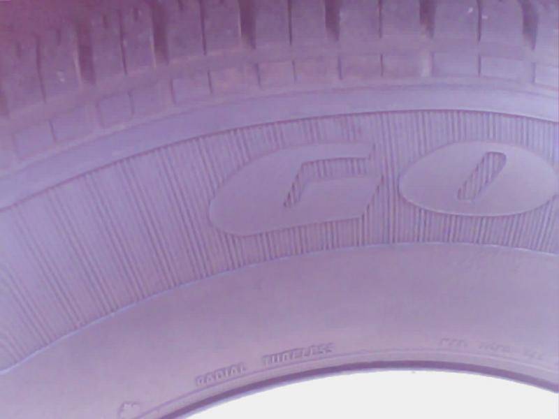

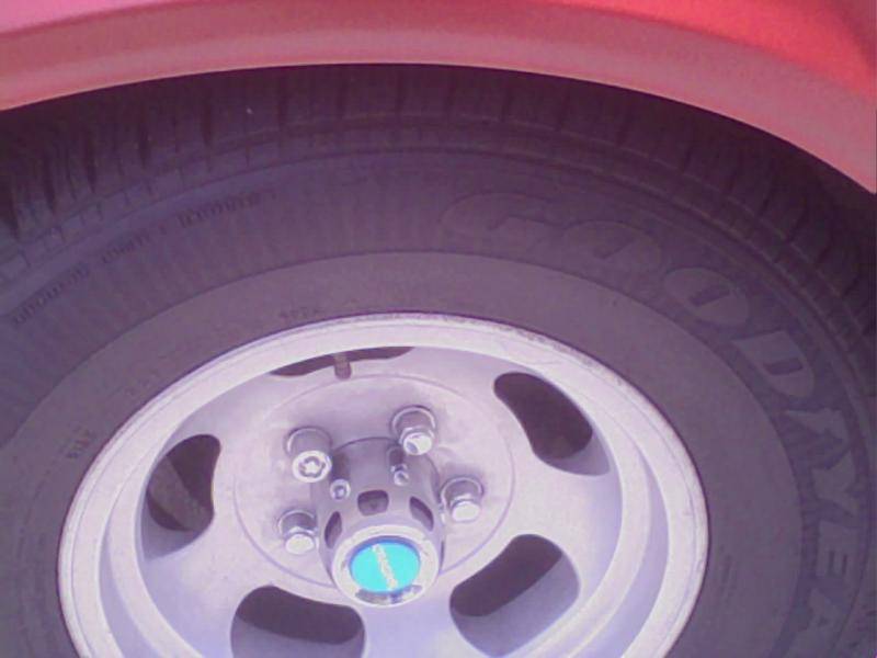

Goodyear integrity 215 75 R14. About 7 years old. My luck with tires is, well, I am over due for sure. They do handle really good. I had cheap trisuns? before and they sucked right off the rack

Nice ride!
Thanks Captain, It's been a good car. I think it was a fleet vehicle as the front end is still pretty tight and I love driving it. I thought about selling it one time until I flew back in and drove it home. Here is the post on the other website from when I got it.....hey I don't think FFMJO was up and running yet. lol http://www.aspenandvolare.com/showthread.php?807-My-daily-driver-to-be

Beater? It looks a long way from beater status!
