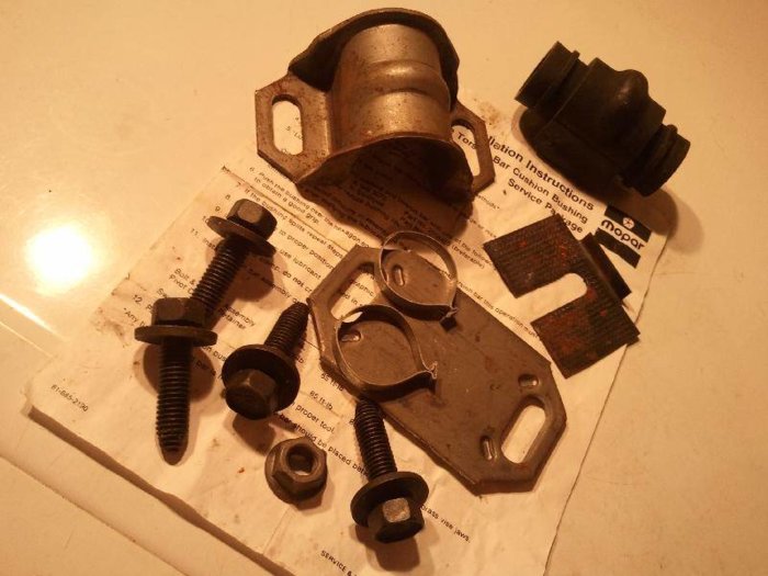

If you buy a complete bar setup from firm feel, I think you could just replace everything new and not bother tearing apart the old shell. Or am I mistaken and it needs to be done anyway to remove it from the car?
2,992
I'm not sure where those are available (or if they are). When I bought mine (around 2002 or so), they were kits from Chrysler and came with the bushing, both halves of the "shell", a new friction plate, the crimp clamps and the bolts. Unsure if you can get them from Mopar anymore.
They aren't listed in the parts catalog, only says "serviced in item 10" which is the t-bar assy. Guessing the field service kit was released sometime later on. If I can find the box, I'll see if the p/n is on it.
2,992
CM360, were you talking about the bushings on the end of the bars at the control arm, or the pivot bushings where they're bolted to the k-frame? Maybe I misunderstood.
2,992
That's the one. Did a little seek and search, came up with absolutely zip.:(

That's them. For $149.00 on fleabay, I think I'll keep repairing them. This adds to the "F M" body debacle.
