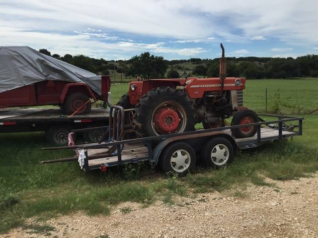

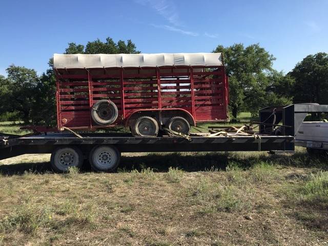

    Here are some of the items I've moved from one farm to another on my 600 mile round trips.
    A good stock trailer with dried out hubs and dead tires.
    An 70s massey ferguson with an awesome hay spear on the backend.

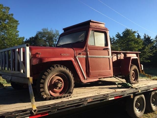

    An old late 40s early 50s Willys Jeep Truck. (correction - 1963 i believe)
    It takes nearly 2 hours each to get them out of the old barn and pulled into position to the trailer and then another hour getting them on to a trailer and back to the other ranch.
    100 degrees every single time I go down there, and then the next day its 20 degrees cooler. Its a struggle.
    Everything that had tires has been sitting several years and all tires are flat, dry-rotted, so its been a challenge. I will be glad when all the equipment is moved and eventually put up at my place or my dad's. Interesting side project this fall that is seriously interrupting my house wall construction.

    I'm thinking the jeep truck is 1963. Nothing about the body is 40s.
    The sticker on the inside looks like it says 43 but the body style is not 43.
    So this must be a sloppy 6 for 63.

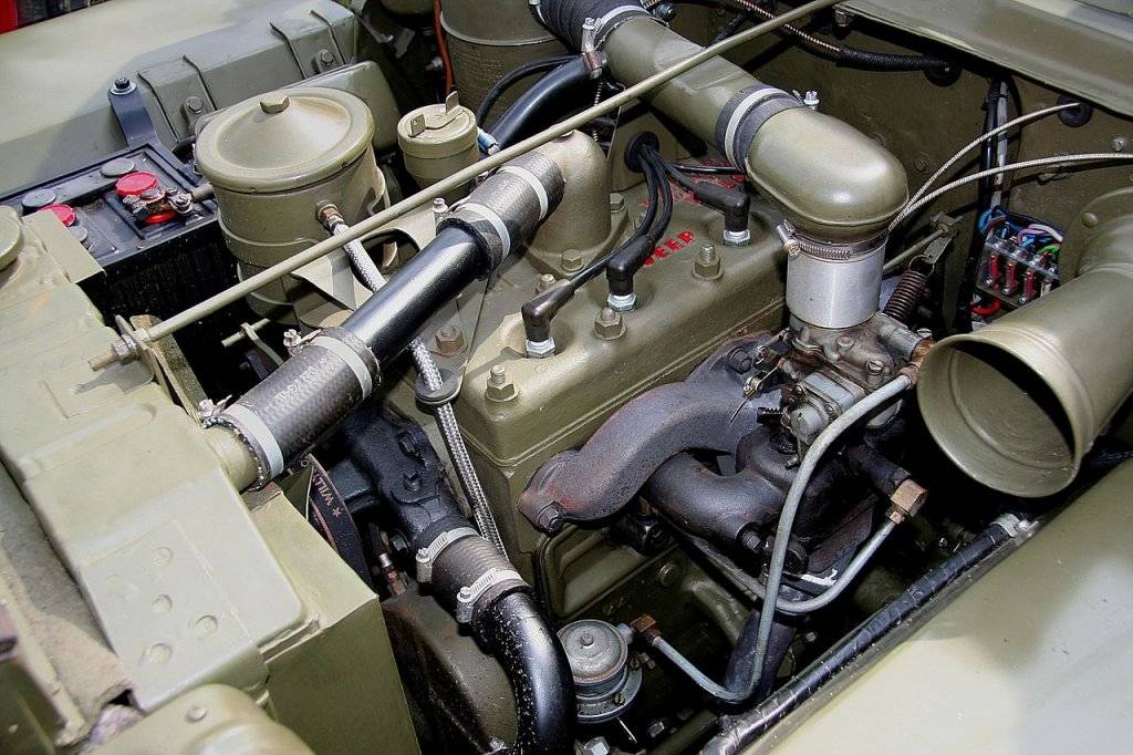

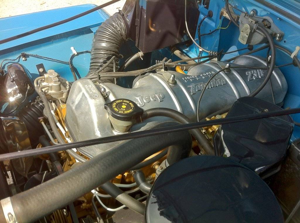

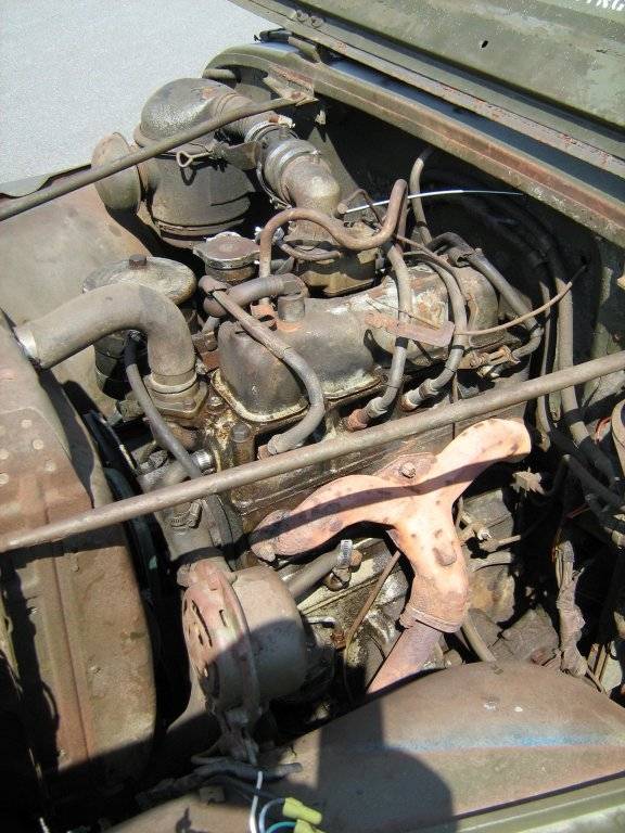

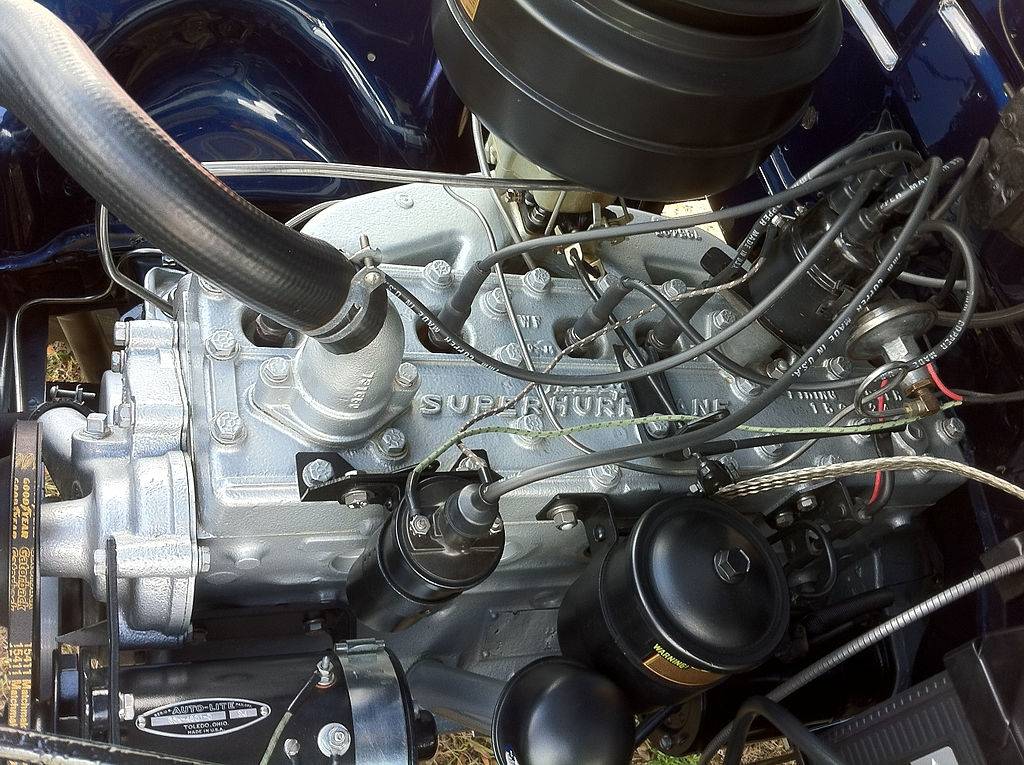

    I learned a lot about Willys, sense your vehicle family grew.
    Couldn’t see necessary details about the vehicle to determine the year it was built from your pictures.
    A good picture of the grill would be a great indicator – but that appears to be easier said than done with that huge bumper on it.
    The engine would be the next indicator of year:
    The Go-Devil 4 cylinder was used ‘47-52
    The Hurricane 4 cylinder was used ’50-65
    The Super Hurricane 6 cylinder was used ‘54-62
    And the Tornado 6 cylinder was used ’62-65

    This is a 1963 Willys Pickup with the Tornado 230 engine.
    It has the power steering from a buick and they also pulled the steering wheel and put in the buick steering wheel.
    I've had time to putz with it a little... some serious rat 'sheeeut' in the cab. About 6 inches deep under the seats and 2 inches in the floor. Both seats have to be replaced. rats scuttled all the padding and peed on them and the springs are shot.
    Have drained the gas tank and installed a new fuel filter.
    Have degreased the top of the engine twice. I'm not very good at it and don't want to screw up something else.
    Have replaced the air filter and cleaned the cover.
    Trying to remove the gas tank so I can clean it out and check for leaks. Its the original metal tank and looks in bad shape. Having trouble getting the bolts off the straps holding the tank in place.
    Have shifted around tires and purchased one used trailer tire and finally have 4 that will hold air.
    Tested both the horns. One works, one needs rehab.
    I've purchased a few other items but will have to wait to work on it since its time to work on the house walls. (Belt, wires, spark plugs, oil, oil filter, radiator fluid, vacuum line, heater hoses -- waiting in the cab).
    The square 'bracing' on the top was to load hay on to. Apparently the back story is this was the truck used to pull the hay out of the field. So the hitch on the back pulled a trailer and then they stuffed the rear and over the top of the cab with hay to reduce the number of trips to the field.
    I checked underneath and the entire bed is rusted through front to back. Is why they put the flat plate in the bed of the truck.
    Looks like I need to find new seats and I'm leaning to late model Dakota with the center console. Guess it depends on what I find at pick-n-pull.
    Next up is, I'm waiting for my core charge and returns money from rockauto so I can get the starter for the chrysler -- on the assumption my tests will prove out that it is a start problem.
