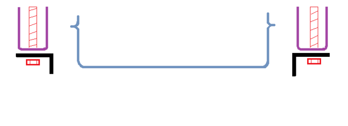

Option one is to bolt (please don’t weld it onto your existing frame – because if you do, you will find out, a month or so later, that you will need to remove something that is now inaccessible, like the fuel tank, for example) it to the lower side of frame rails.

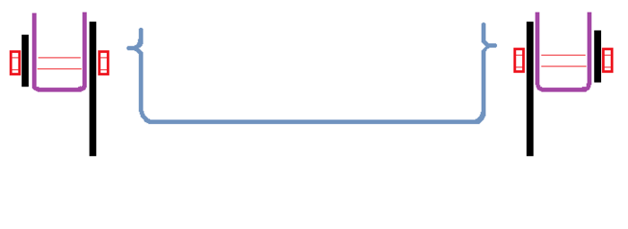

You can bolt it onto either side of frame rails.

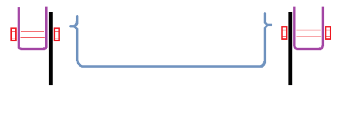

An option to above is to add reinforcement plate on other side of frame rail (to avoid crushing the frame rails when tightening bolts.

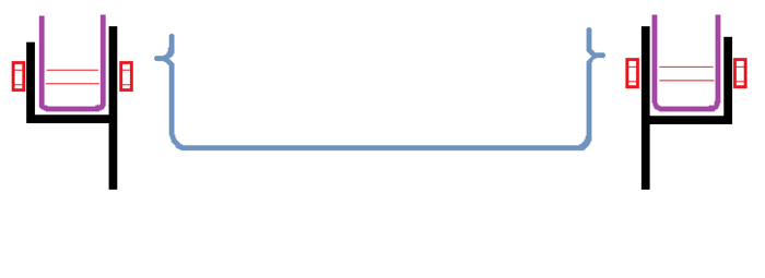

You can make a C-shaped section to the hitch that will cradle the frame rail (what I recommend).

The C-shaped section method would be by far the best (last picture) – but the most labor intensive to create.
Those frame rails are not that strong, and it doesn’t take much to crush one when tightening bolts.

If you drill holes with a step bit into the frame you can slide pieces of pipe through the holes. You'll never hurt anything with the diameter of say 1/2" water supply (Galvanized) pipe through the frame used as crush proof sleeves. Angle iron or u channel ideally. A fun and rewarding afternoon in the junk yard and another under the car. Use Buds pictures, he's a smart guy and a real wiz with his drawings. You'll be able to hook to your house and relocate whenever the mood strikes.
