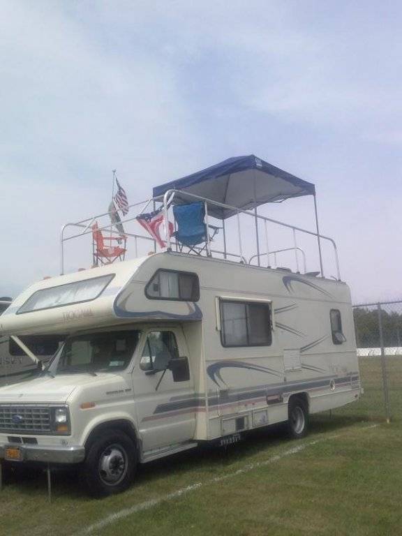

Is sitting on the roof of one of those RV's a good idea? I thought they had a rubber membrane roof; are you not worried about damaging it? Plus is that roof really deigned to support multiple people? Did you do special roof reinforcements for your spectator purposes? I like the addition of the railing. Is that permanent, or something that you install once you arrive on location of the race?
10,746
1,209
His roof definitely looks reinforced....almost looks like checker plate. I know my park model is aluminum. You can walk on it but I wouldn't want to party on it with other people.

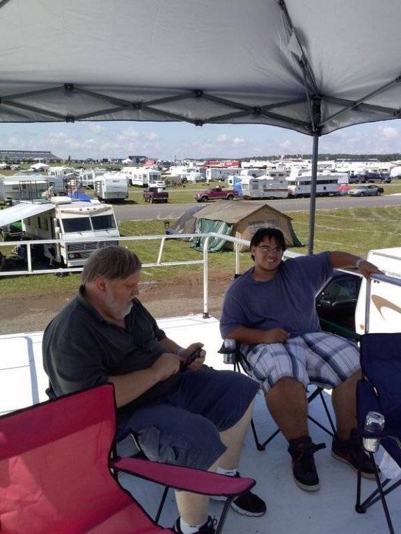

The standard rubber membrane was removed as was the 1/8" luan wood below that. There is a metal frame work, by no means designed to hold the weight of 10 drunken men.... lol
I removed the rubber and 1/8 wood.
I put down 1/2" 4'X8' marine grade plywood. I covered that with Grace Ice and Water Shield UnderLayment. And then put 4'X8' sheets of aluminum diamond plate down. No worries about damage from chairs or trees! The safety railing is 1.25" Rigid Aluminum Electrical Conduit with 3/4" Rigid Aluminum Conduit posts. The safety railing is easily assembled and disassembled. Once assembled, I teather the chairs and 8'X8' pop up tent to the rails of the safety railing using some 12AWG Solid Wire. Upon being disassembled, the safety railing lays on the roof and is tethered with the same wire.

Very nice!!!
I'd do that to my trailer but then I'd be driving my buddy to the ER every weekend after he fell off.

Well done ob that roof build. That is one rockin' party machine!

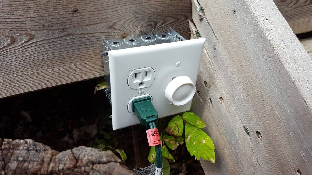

My wife is all about lighting. It has to be the ultimate mood setting brightness, colour, etc....
Apparently according to her our outside deck lighting was too bright and we can't have that so......I made a redneck dimmer box. Now she can just dial it in. :D

A question I have, is will it be in a location it can get wet?
10,746
1,209
I like it, Captain.
Yes.....but.....I wrapped it in fashionable foil tape and I always leave it unplugged when it's not in use. I've blown up more than enough stuff in my younger years to know the precautions to take.....lol. :D

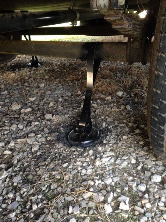

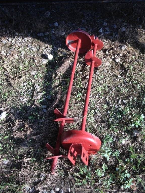

After the first real good wind storm I could tell that was wife was scared by the rocking of the trailer so I ordered some mobile home tie downs. I used grade 8 3/8" bolts on the front anchors and 5/8" bolts on the remainder. I have five done and three more to go. I have to turn them into the ground with a 2 1/2' pry bar. It is a good work out.
