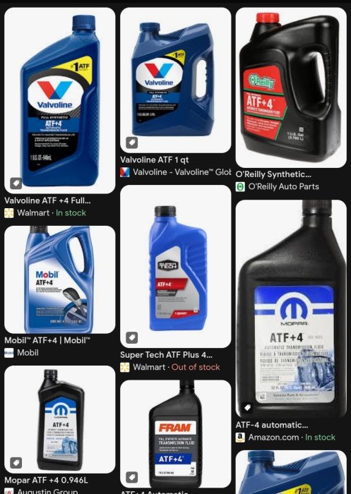

Just use the ATF+4, which is synthetic, and replaces ATF+3 and Dexron I, II, etc...You're over thinking it too much.

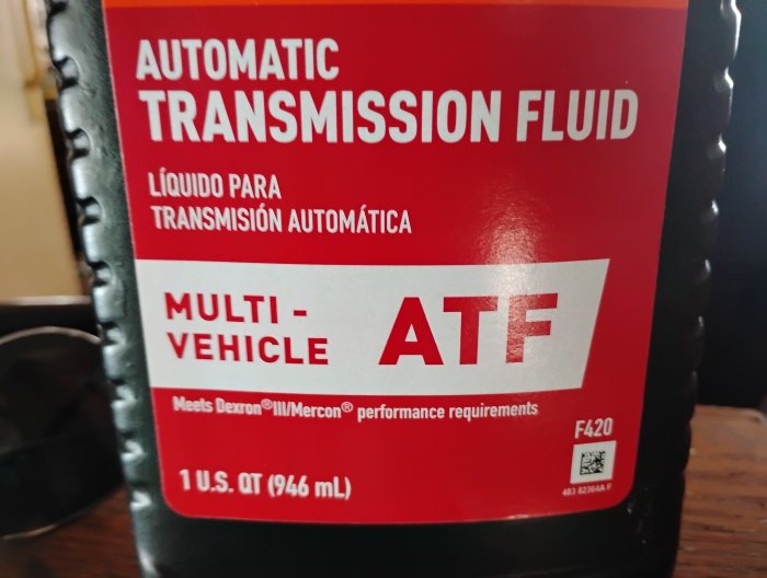

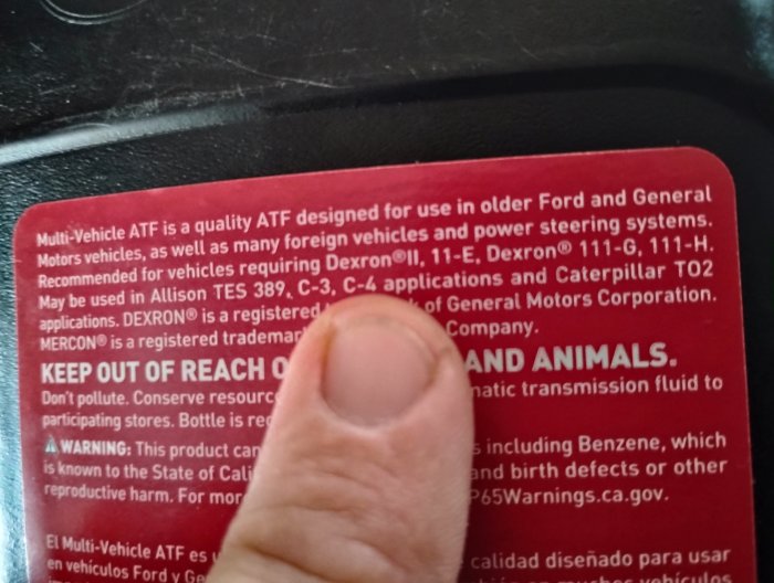

Just to clarify, C-4 is a ford transmission, it has nothing to with ATF+4
ATF+4 is literally the name. ATF is not the same as the ATF+ series
