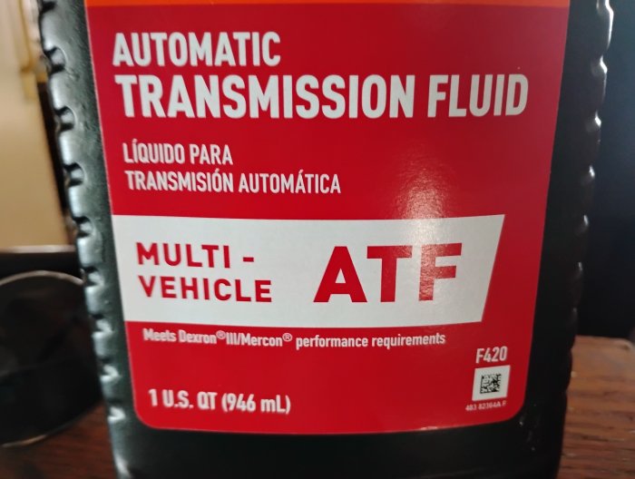

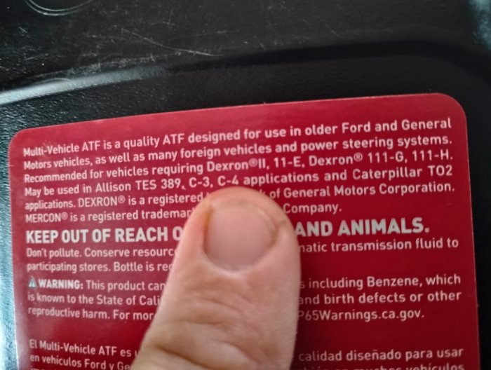

MoparDan
Mar 17, 2011
814
387
Daytona Beach, FL
Is this the right stuff? IMG_20240718_173738943.jpgIMG_20240718_173757913.jpg
3,171
818
The old Ford Type F is all that is needed, now Ford type F is just standard hydraulic fluid that has a red dye in it.
If you have a higher stall converter where the fluid will run a higher temperature then you should consider using a synthetic transmission fluid.
