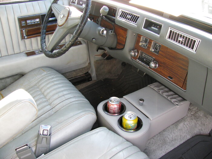

So anyone have cup holders. Most luxurious car Chrysler had in the 80s and no cup holders
Link:Low Rider Floor Console, Universal Fit - Classic Consoles
