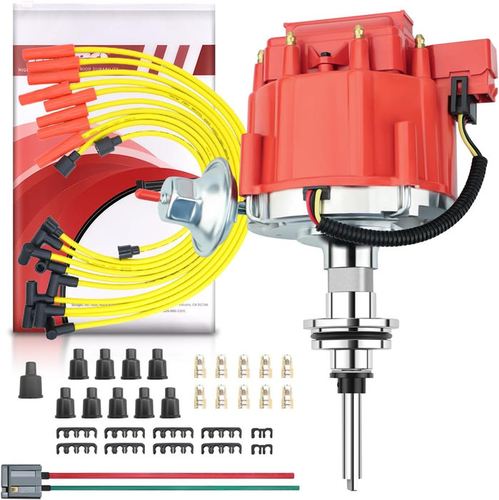

This is what I used on my 87 Fifth Ave.
$75 for the distributor, wires and pig tail. The cap can be clocked every 90%, takes about an hour. Plenty of room.

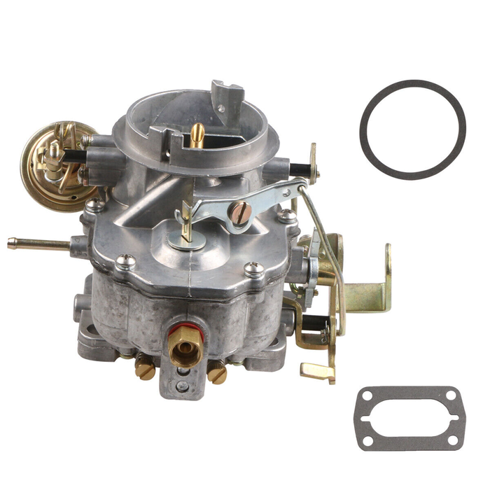

$75 for the carb. For a 70 Mopar.
Both work like new money, from eBay and Amazon.

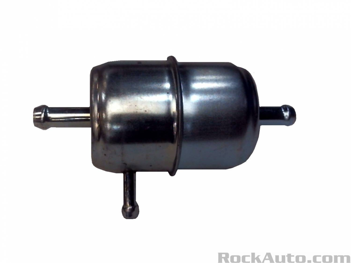

And the return filter for vapor lock.

The mopar distributor king, Halifaxhops on For A Bodies Only, can hook you up with an HEI set up

You just need a Carter BBD two barrel for Mopars, non feedback. And that ignition OLDIRON posted up top is a good one. I prefer to keep it looking Mopar so I used a Mopar Performance ignition kit.
