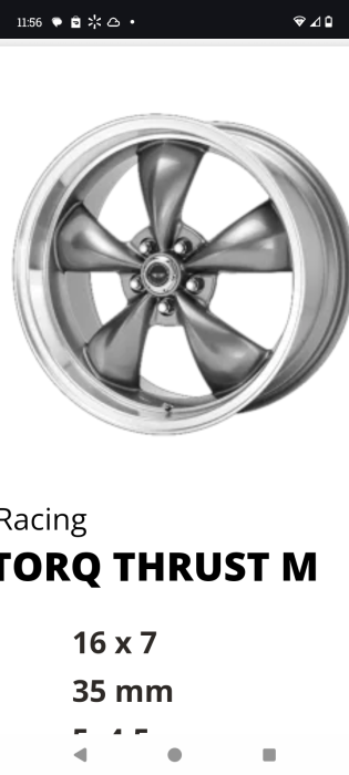

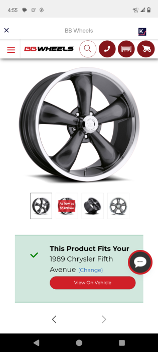

So what are y'all's thoughts on these.

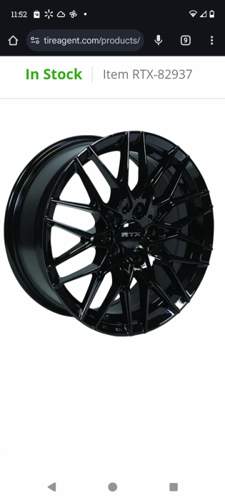

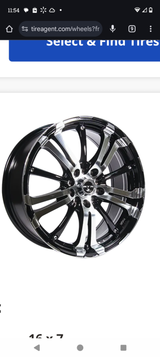

Torq thrust wheels only look right on Ford/Mercury cars and trucks, Second set of wheels don’t do much for me, Third set of wheels don’t bother me, I’d throw them on a Mirada or Imperial without much thought, IMO.

Thanks. I kinda thought the same on the thrust. I just didn't know how a newer style like the black ones would look lol
1,848
1,048
Torque Thrusts compliment anything with chrome. They basically modernized Cragar S/S wheels. Don't care for the other options all that much. I wouldn't go taller than 17" with stock springs.

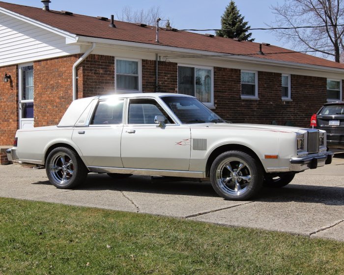

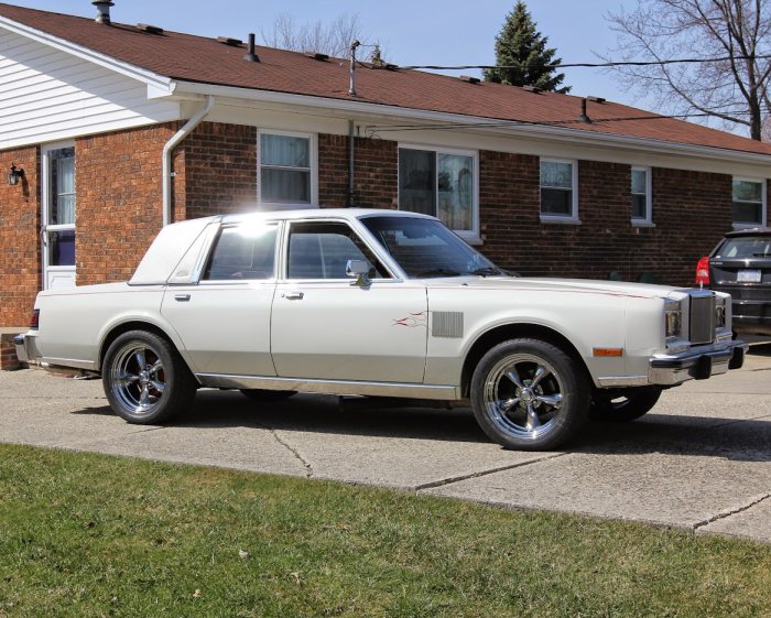

Torque thrusts look good on pretty much anything.
The other 2 would look way too new and goofy on older cars.

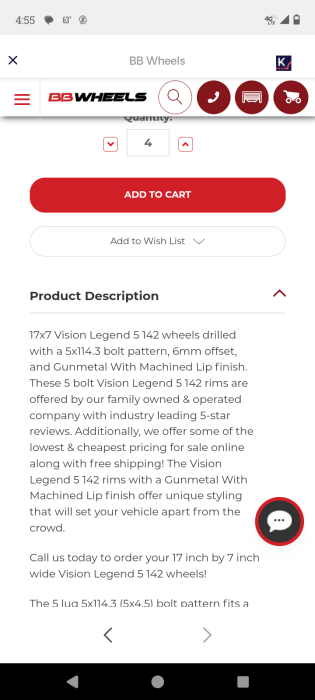

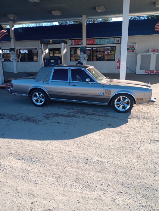

Rims are 17x7 0 offset. Sl215/60/17
Might be too tall for the front end. 215/60R17 is a 27.2" tall tire. You would have to run it to be sure. With as soft as the factory suspension is I wouldn't. The tallest I've ever run on the front is 26" and change.
Factory tire I believe is 205/70R15. That's a 26.3" tall tire. If you want all four to be the same size I would run 235/50R17; which is also a 26.3" tall tire. 235mm tread width will clear upfront on a 7" rim with no offset.
If you want an offset stance the rear wheel well will accommodate max height of 28" and the max width of 285mm (you'll have to give a little in either dimension, both at the same time won't fit)..

Thank you so much for that. I'm going to start looking.
