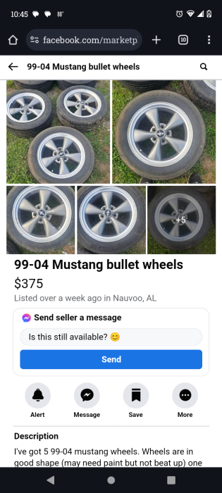

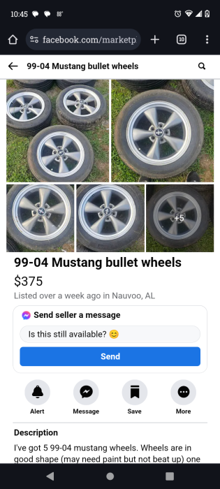

These should fix correct? How about back spacing? And if chang the center cap of course lol
AMC Diplomat
Feb 14, 2023
1,754
828
NY
It's been awhile, but I think the SN95 Mustangs had a stock backspacing of 5.7" and the stock backspacing on Mopar police wheels is 4.25"
I don't know if you can cram almost an extra inch and a half of wheel in these cars.
Plus I think the Chrysler center bore is bigger than the SN95 Ford center bore, something like 73mm vs 70 or 71, so the SN95 Ford wheels might not even fit on the car because the bores are smaller.

Ok so basically If I want them to work I'll need spacers. Which brings me back to the 30 year old parts being under stress.
