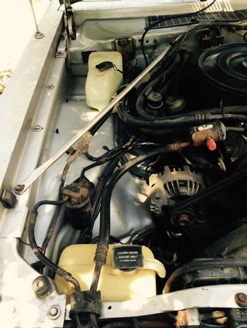

Oh lordy ... do I have some stories from this continuing saga. I only got to 1/3 of the engine compartment today-passenger side.
I have pictures as well, but have to post them later...

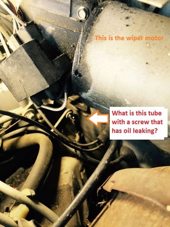

So what is the empty port on the selenoid at the center of the firewall, near the top? Whatever it is, my windshield wiper fluid bottle line was connected to that instead of the connector in the underside of the hood for the water dispensor to the windshield.
There where 2 cracked vacuum lines coming off the vapor canister and a cracked line at the vent bowl.
Some goodness-knows-what animal was living under the coolant overflow bottle and behind the vapor canister. Gross, nasty, I sputter with indignant remarks....
I also need another overflow bottle. The bolt that goes through the side of it through the frame so you can lock it in with a nut was completed rusted and would not release. There is now a 2 inch crack in the bottle and the rusted bolt can be held still so the nut can be backed off.
More later... gotta get to town to pick up chain saws before the place closes.

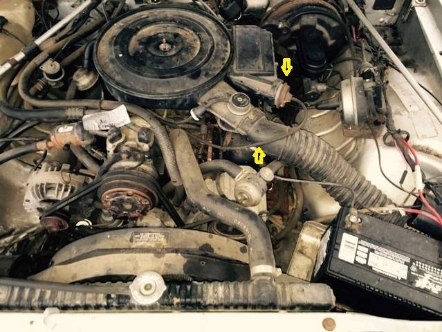

Here are the tree limbs and ash tree volunteers coming up that I cut and hauled up the road to the goat pen cause I don't need anymore biomass fuel laying around on the property.

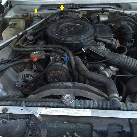

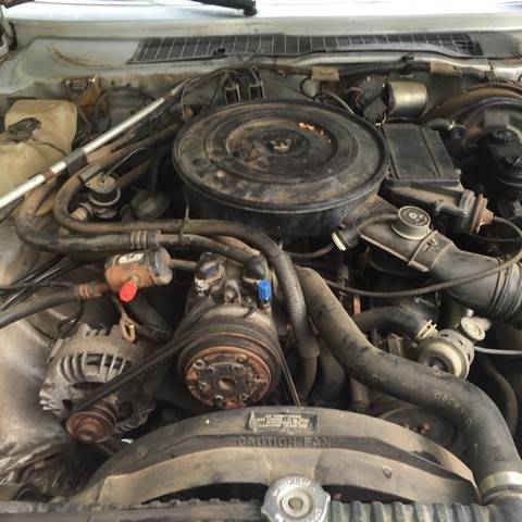

The engine bay before I started ... notice those two fine looking, brand new a/c ports!
And notice the two yellow arrows?
Those two yellow arrows ... are showing you a 1/4 inch vacuum line from the washer bottle to the left. The termination should be on a connector located on the underside of the hood. So the water can get out of the bottle, through the line and onto the window.
Instead, my washer bottle line is connected to a port on that firewall... What the heck?
Good thing I have not filled the bottle with liquid or I would have been dumping water into that port.

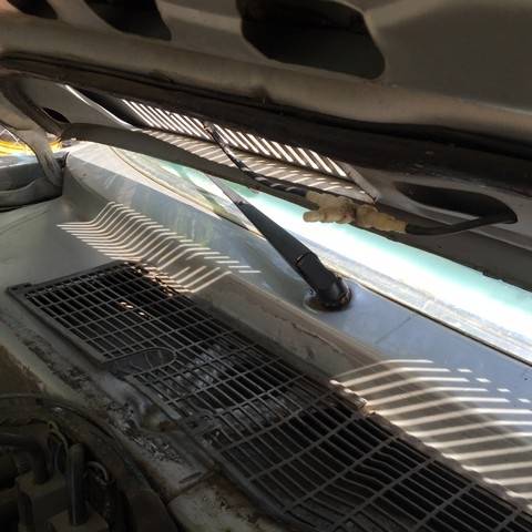

Here is where the line should have been:
The white connector about in the middle of the picture, just at the bottom of the hood.
Another view of the engine compartment:

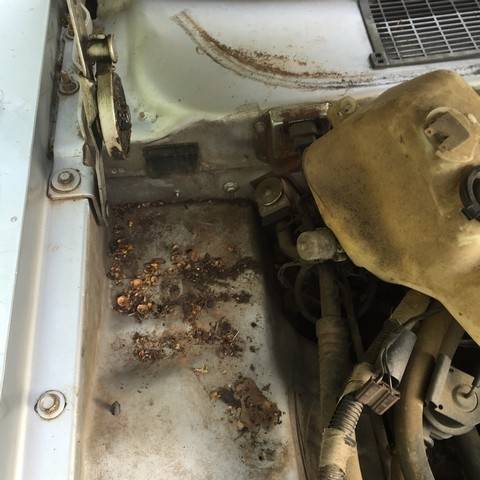

I removed the washer bottle and found this lovely mess.
Whats frustrating is last week I already swept this filth off. This happened last night. Some nasty mouse got back in there and ate an evening snack of stale acorns...
I'm going back to moth balls in a plastic bottle and see if I can keep them out. Just have to remember to remove the bottle before I drive too far.

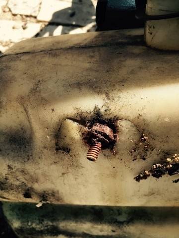

This sad situation is a rusted bolt with a rusted nut on the back side of the coolant overflow tank. Yes, I had to bust it to get it out. There was no room to cut the nut off since it was blocked by the front metal behind the header panel.
--- Post updated ---

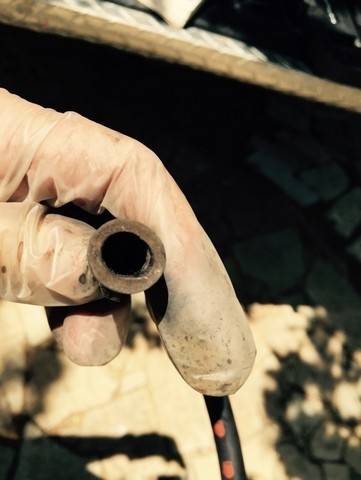

As we continue to the vapor canister:
This is the black round coffee can shaped under the coolant overflow tank. What? You don't recognize it because I cleaned the black filth and crap behind it.. Yes, that is actually silver paint. I do not know what was living behind the canister and under the coolant bottle but they had one fine looking nest in there.
Not anymore!

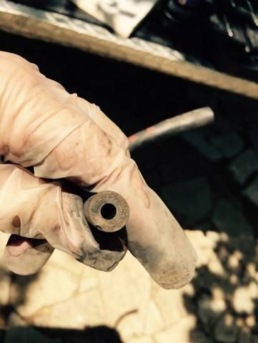

Notice the fine looking set of cracks on the line to the left. You could only see them if you removed the canister and looked on the underside.

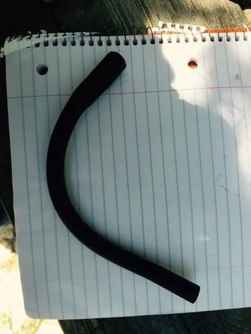

This was the only hose on the canister that I kept. Both the the ends were different sizes and it had very attractive red markings on one side.. Looked like a specialty hose.
I did replace one other vacuum hose that went from the bottom, front of the carb up and around to the driver side to a rusted port .... the line and the rusted port are at the yellow arrows in this picture:
So here is the finished 1/3 of the engine compartment:
And yes I removed rust and spot painted the metal.

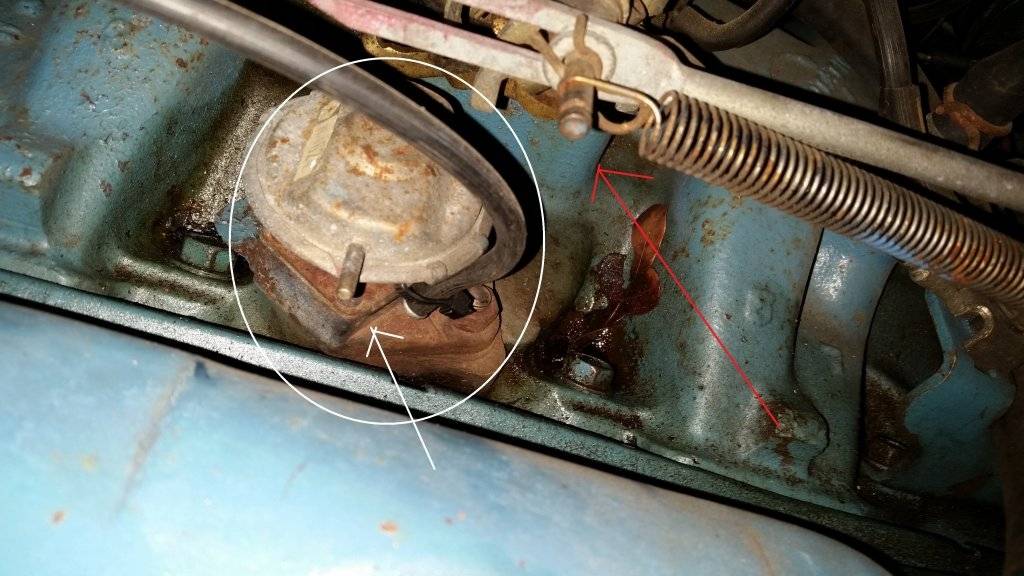

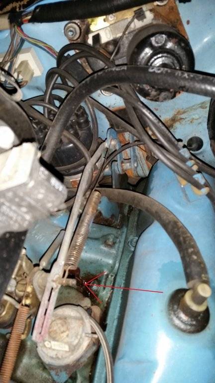

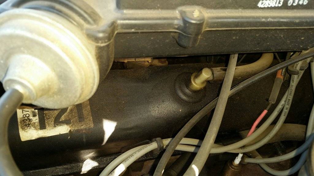

1. How do you get the small lines at the back of the carb lose from the t-connector? I didn't want to break the connector but jeeze they don't want to come loose.
2. Do I really use just plain vacuum tubing for the engine hose replacements that are 1/4 inch-- like the tubing in the package I was sold that says 'for windshield washer'?
3. I'm looking at page 7-7 of the service manual and there is no indication how to remove belts; just plenty of information on how to tension them properly. The dually has a tensioner pulley to move so you can take off the serpentine. So for this novice lady, am I supposed to release and move the alternator bracket so I can remove my a/c compressor? (remember I'm backflushing and swapping oil to convert the cooling system over to r134a).
4. Should I replace the hose from the canister in the above pictures, the one with the pretty red spots on it? It looked to be in good shape, but 'you should change out your hoses' has been commanded and I'll need a part number if that one is coming out.

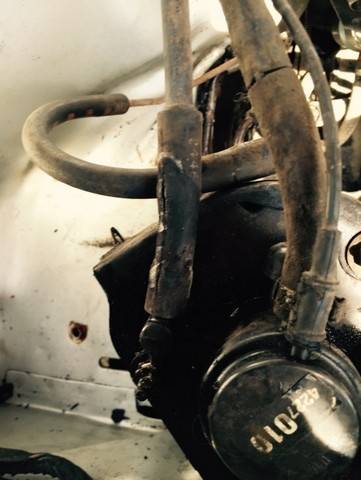

5.There is oil residue in two places: 1) around the opening where you put oil in the crankcase(?) and 2) dripping from the vacuum pump on the back rear firewall (next to the starter relay?). I assume the oil on the crankcase is from the previous person adding oil without a funnel. There is also mice pills and flaking black paint in that area and just above there under the edge of the carb. How do I clean that?

The white washer fluiid hose connector (under hood) is not the correct one. That white connector is a “one size fits most” replacement - but if it works then no need to change it.
What did you use to make your washer bottle sparkle? I might have to send a huge box your way, just to make use of your cleaning processes (I can get things clean, but not where it sparkles).

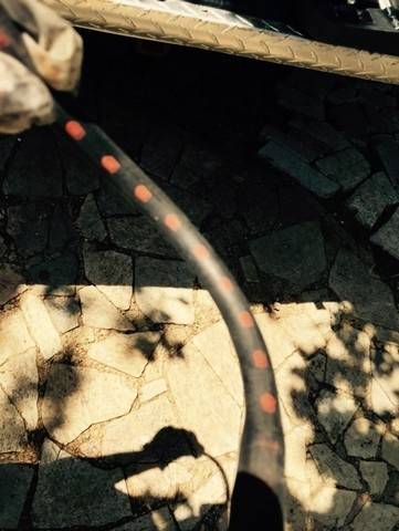

Sometimes vacuum hoses are color coded from factory, like the red/orange dashed one you have, to aid the assembly of vehicle.
The vacuum hose (with the two yellow arrows) goes to the ELB (Electronic Lean Burn) computer. The hose connects to a sensor (the rusty round thing pointing to the cruise control servo) that tells the ELB computer how much load to engine is present and it adjusts the ignition timing accordingly.
Question 1.
Can you take a picture of said item?
Generally, I will take a small flat screwdriver and get behind the rubber hose and base of whatever hose is attached, and pry hose in direction hose needs to come off of. Most cases, it works fine.
If replacing the hose, you can take a knife and make a small cut in hose parallel to the hose and twist.

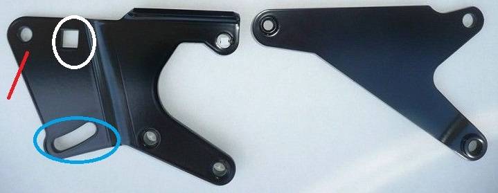

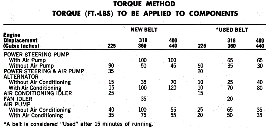

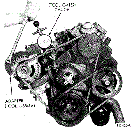

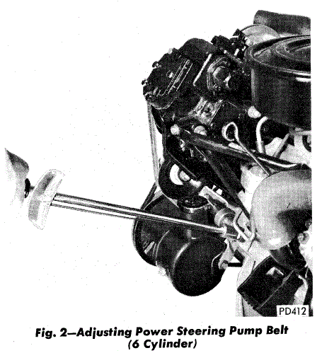

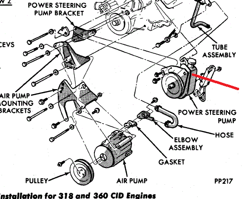

Your car has 4 different drive belts on it. A “matched” pair for A/C and Alternator. One each for A.I.R. pump and P/S pump.
The P/S pump has four mounting brackets, two each for engine and pump. The front most bracket on P/S pump has a ½” square (see white circle - in picture) on it that allows a ½” drive ratchet (or ratchet and extension) to attach to it to assist tightening the P/S belt. There are two bolts (9/16" head, I think) that are have a red line (pivot bolt - in picture) and blue circle (adjustment bolt - in picture) – both need to be loosened a couple of turns, and pump belt should go slack when loose enough.
The A.I.R. pump also has a bracket with a ½” square for ratchet for adjustment. I do not know off of the top of my head on what bolts to loosen for adjustment (two, I think).
The Alternator has an 9/16” bolt head close to A/C compressor and a ½“ bolt head close to fender to loosen for that belt adjustment. Having the correct tool to tighten the alternator belt is most helpful, but other devices could be used. Just be careful not to break anything...

Question 4
The term “change your hoses” mainly is meant to radiator and heater hoses. If those were to burst, you could be stranded in a dark alley somewhere without much to do (other than break out the tennis shoes and start walking).
If your vacuum or vapor hoses are not cracked, or hard (otherwise pliable) then there is no reason to change.
If hard, cracked/split, then it needs to be done.
Question 5
Need better pictures/not sure what is being referred to.
Note: I love the yellow arrows. You need to show me how to insert those babies.

Dawn xtra strength dish washing detergent on things I could take out of the engine compartment. I think things just look cleaner compared to the 2/3rds of the engine compartment that I left filthy.
Put mothballs in there this afternoon.
So there is a 1/4 vacuum hose I should use which is thicker walled than the 1/4 inch windshield washer line. I'll check down at the farm co-op on Monday.
After the weather moves through here on early next week, I'll be easing the tension on the compressor belt so I can move it out of there and flush, new oil, new parts and get this a/c charged back up.
Today, it was like driving a different car No dying at stoplights or yield signs. Twice i backed up into a parking spot and it only died 1 time. But I still need to check the fuel lines and the other 2/3 of the vacuum hoses. Its also probably pushed the good gas through the lines and fuel filter. Sure seems peppier!

black goo dripping down ... I have a picture ..
In a previous post, captn said it looked like oil from the vacuum motor. So I'm just now following up.
3,615
1,015
agreed. I'm still learning what everything is called. I've got the passenger side of the engine compartment cleaned. Working on the center next weekend. So it will be another 14 days or so before I check out this problem. Its all an adventure.
The item you call a “What is this tube with a screw that has oil leaking?” is part of your transmission kickdown linkage.
To demonstrate, the next time you are under the hood, remove the large paper air inlet hose from air cleaner, and the wing nut. Then pick up on the air cleaner assembly a couple of inches.
Then find part identified by the red arrow in picture, place a finger (or two) and press that rod/stud (pointing towards Left Fender) back towards the firewall about 3-4 inches (with car off). What you just did was work the carburetor by hand - as if your foot pressed down on gas.
Next find the metal linkage going towards firewall from the stud. Push the front part of that linkage back about 3-4 inches. It might move the throttle stud a bit - but no worries. That linkage travels through a bell crank with a downwards action at rear of engine. There is another bell crank under the car that makes a rearward action to a lever on transmission.
It would be hard to do - but if you can imagine you were cruising down the road at say 40 MPH (with hood up and you standing by left fender) and you could move that kickdown linkage (only) rearward, the transmission would downshift from 3rd gear down to 2nd gear (or maybe down to 1st) gear, but sense the throttle is not doing it, the car wouldn’t jump in speed.
That rod has no oil or grease to it for it operates dry. The oil you see, is coming from the wiper motor gearbox. The grease in the wiper motor has liquidified and is now leaking. I don’t know if it is worth the effort to fix. I would clean up the wiper motor and linkage and that problem might go away.
I took a couple pictures of my ‘77 wagon. It has mostly the same setup, but engine is blue (not black) and firewall is easier to see. Actually the very first time I had the air cleaner body off of this car.
One of the things I discovered tonight is I have been victim of the EGR Valve gremlin (see thread Pinging).
Honest, I didn’t do it (um, this time . . . add eyeroll here). Someone went through the trouble to ziptie the hose to the EGR valve (a lot more work than I would have done). See white circle (EGR Valve) and white arrow (vacuum hose port)
Note: Vehicles with ELB do not use a vacuum amplifier - so she does not have a “vacuum amplifier” on her car.
