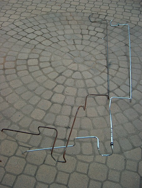

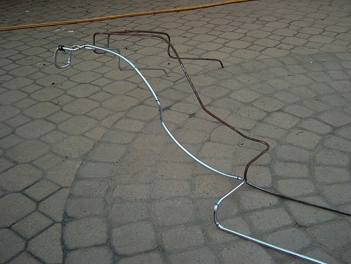

A long time ago, I purchased a badly rusted out ’84 Gran Fury police parts car. One of the things I had removed was the fuel lines.
My plan is to make a set of stainless lines for each car, using 3/8” for main fuel line, using these as a guide.
Personally, I think having a return fuel line is beneficial especially in carbureted cars (vapor lock) – but I do plan on using fuel injection – so not sure what recommendation will be for that is, yet. Waiting on $ for injection system(s) before starting any line making. I do have the benefit that current fuel lines are in good condition.
I have rolls of stainless tubing in my garage and a cool set of bending tools and bubble tool/flare tool set (all from Eastwood) that I’m (sorta) ready to try out.

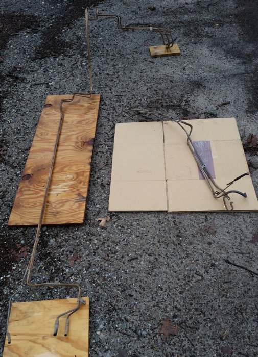

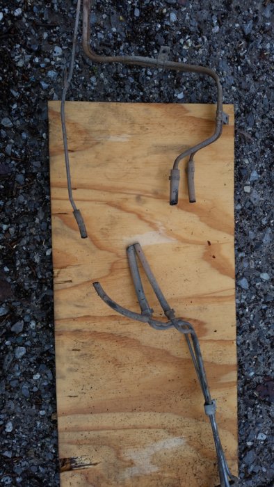

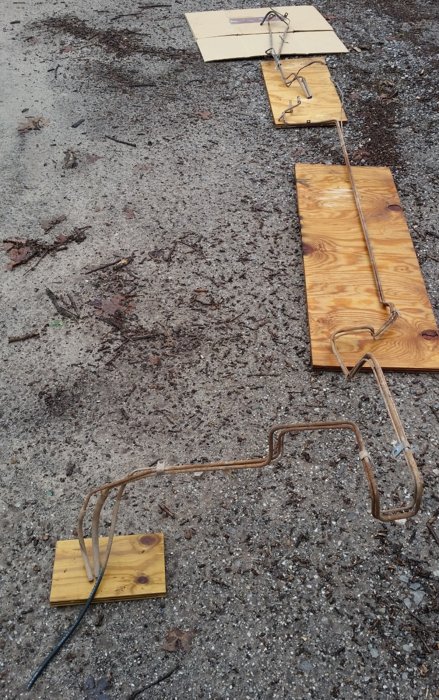

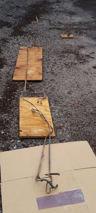

Here are some photos of those original fuel lines (if it helps you).
I do not recall the length, but the rear lines are all a “standard” length (maybe 16 foot – I can’t recall) – which is why I suspect there are 6 lines instead of 3.
