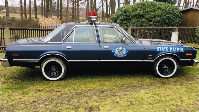

Hi,
i bought this car a few weeks ago in Germany not knowing anything about the history. I hope you can help me out...
What I got:
Vin number says:
H... volare
P... premie
41... 4door Sedan
K... V8 369cui, 2bbl
6... 1976
F... Newark, Delaware
First Registration was 1977!
The decals show it as a car from the Missouri State Highway Patrol...
The equipment equipment seems authentic...
Are there any experts can telling me more? Thanks

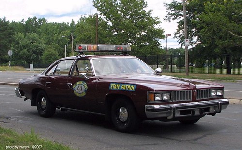

I've seen plenty of upper trimmed cars for Sherriff and Highway patrol duty. Some are unmarked and some are for upper ranking officers.

some informations I have forgotten to tell you:
the car is completely paint with this blue and black color, as you can see the engine compartment too but the trunk is not! The trunk is colored in original green...
The speedo is a 200kmh original... there was a discussion here too but I didn’t understand all. I’ll post a picture.
has anyone of you the possibility to watch the history of the car by VIN? Maybe it’s possible to find out where the first registration was?
the lightbar is definitely Orginal (I sax the same in a brochure for dodge police package)
I posted some pictures of cars having the same equipment like mine...
1. pic quit the same equipment
2. same lights with the same badges!
3. same speedo (maybe rebuild for export to Europe)
4. same wheels

The light bar is era correct but cars usually didn't come with them from factory. They also usually order police cars the color they want them and then paint them when they are finished with them and they usually don't have pinstriping.
While it could have been used as a police car it could just as easily be a normal Volare that someone made look like one.
Those aren't Chrysler police wheels.

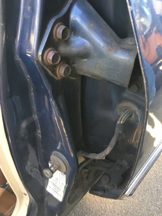

The Vin seems removed (as you can see behind the front window... maybe becouse the sold it to Europe as a police car?)

Post a pick of your import/conversion tag on the pass fender and the fender tag on the drivers side under the cruise servo.
You export/import tag will have info and your fender tag may show if it was ordered by a municipality or specifically built for export.
The most common car used in 76/77 was the pontiac lemans .
And your car dont show some of the attributes of a F cop car as they werent into it in 76 but you say it was plated as a 77. But that dont mean the MSP couldnt of snagged one.
that sounds good I will look up.

You're right, the equipment does look period correct but like a couple of us said that could have been easily added just like the decals.
That rear sway bar is aftermarket. The monroe air shocks you asked about is also aftermarket and at that age replacing them would make a good improvement.

but,you havent posted a pic of that fender tag under the hood yet soo?
i guess ill have to wait to see that first.
