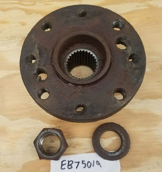

Most all Chrysler rear differentials changed to a flat differential flange yoke (much like the ford flange) in the mid ‘90’s. This applies to pickups, vans, Dakotas and Jeeps – sense there were no rear wheel drive cars made after ’89 (until 2005).
I have “heard from a friend” who said the GM rear yokes are the same as the Chrysler flat flange yokes – but I haven’t even looked at one to compare (could be an old wife’s tale, for all I know).

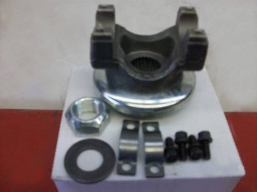

The rear yoke from ’65 to mid ‘90’s:

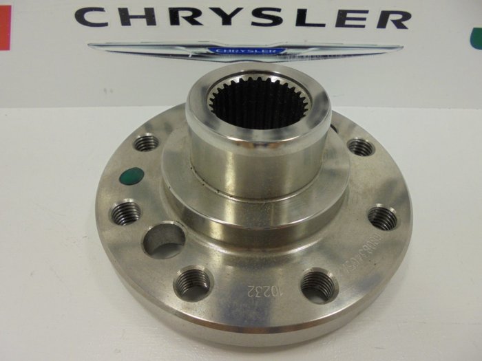

From mid ‘90’s to present.

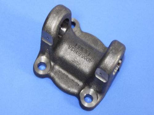

Propeller shaft part.

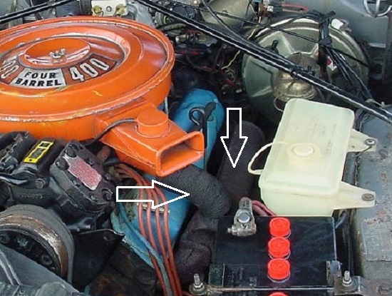

The Left side is missing a tin heat shield (white arrow, below) that allows air cleaner to get hot air for better cold drivability (if not fuel injected). If you don't plan on driving car when its frozen out, this won't matter much. Fuel injection wont need or want this in place.
