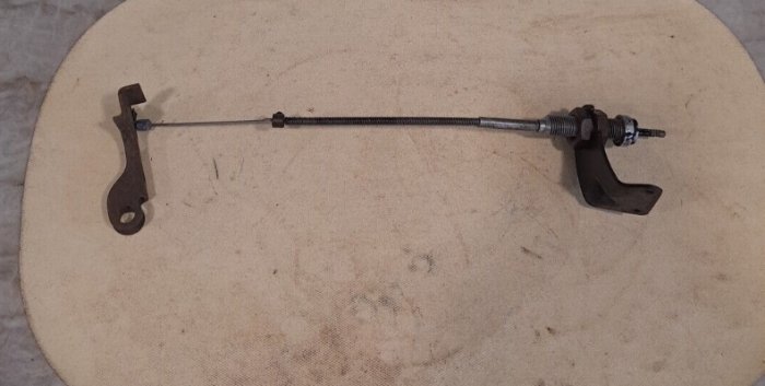

I came across this ebay listing today:
https://www.ebay.com/itm/386980920180?
Seller description
"RARE, VINTAGE, PLYMOUTH VOLARE POLICE CAR, INTERIOR THROTTLE CONTROL CABLE WITH MOUNTING BRACKETS. THIS ALLOWED THE DRIVER TO INCREASE THE IDLE SPEED TO ASSIST THE ALTERNATOR OUTPUT. MISSING THROTTLE KNOB. CABLE WORKS EASILT. PLEASE CHECK OUT ALL THE PICTURES. WHAT YOU SEE IS WHAT YOU WILL RECEIVE. NO RESERVE. DAVE"
My question is, wtf is this thing really? Did Volare police cars have a throttle control in the dash? This seems like a great way to install a half assed cruise control or a great way to improve your 60 ft and reaction time at the track by holding your throttle open

I remember working on squad cars with one of those. It was for the exact purpose the ad says. When drive by wire came about, I can recall adding a kit to a couple squads for idle speed control. No cables, just a rocker switch, a small module and a few wires. Flip the switch and instant 1,500 rpm. They were "smart". It only worked if the parking brake was on. Pretty much the same thing that tow trucks and other equipment with hydraylic pumps use. Anyways, story time over now, lol.

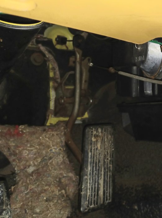

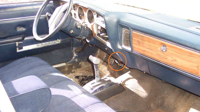

here's the only old pic I could find from a '85 NYSP Diplomat that had the throttle lock. My 1986 did, too, but no pics. No the B&M floor shift isn't stock and I sure didn't do it! :)
Both cars are from long ago, and both are sadly long gone. Hope this helps with the placement, I seem to recall it attached to the dash frame and then down to the gas pedal.

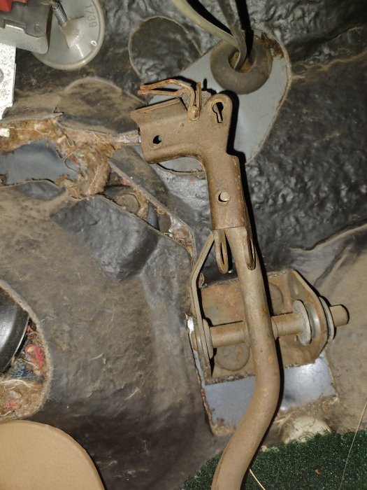

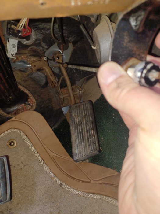

Alright, who can help my smooth brain understand how this thing connects to throttle? It's like a game of tetris and I'm rotating it to get it to fit
