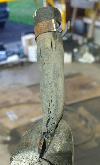

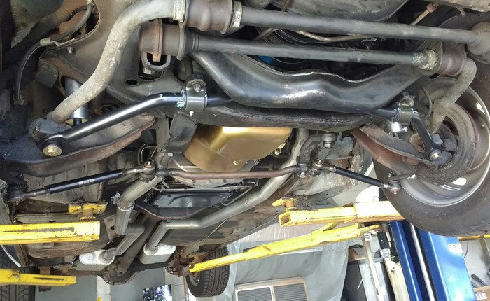

- Fast ratio Pitman and Idler are in with the 11/16" tie rod hardware. Old idler ball joint was dust. Nearly fell out in my hands. Yikes.
- Found the steering plunge coupler was half the cause of the full inch of slop in my "suggestion wheel". Found a slightly shorter (3" instead of 3.5") replacement at Bouchillon. Still worked fine. Thanks to Aspen500 for those links.

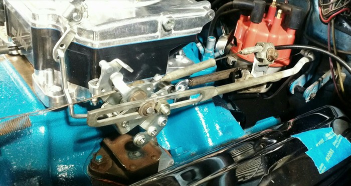

-Oh and I had to bypass Lean Burn. Cheap GM HEI setup with Denso Iridiums thrown in for now. Finally got rid of the pinging and got the idle down where it should be but now I lost my vacuum advance. 2bbl doesn't seem that happy anyway. Maybe time for a reman Demon 1901.
